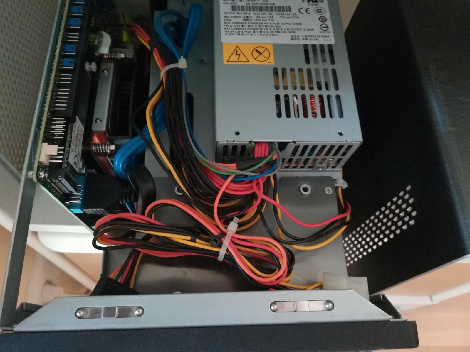

A CPU at full load in a well-cooled case should go to around 60C. If it’s an SFF case I can see 70C. Anything above that, and cooling needs to be re-thought.
CPUs can run at full load for days and weeks and months without overheating, if the system has been built correctly.
The CPU cooler you used was designed for static pressure, forced air 1U server chassis. That’s not what you built in. You built in an SFF PC case, and that means your cooling solution needs to match. I found some threads online about what coolers people use in the exact case you use, I am sure you can find them too.
Horses. Water. Can lead one to the other, can’t make them drink.
Just in case though: Try and stay curious, assume you don’t know everything. Everyone tells you your CPU is allowed to run at full blast without overheating. Maybe there’s something to it. Explore that possibility.
man, i'm not trying to be a smartass here,
- the static pressure cpu fan, seals around the CPU and forces up into the open space of the case
yes, you are correct - but
a) it is the only fan that fits in the space between the cpu and mounting case
b) i have already said, i will 3d print a flange that clip onto the extraction part and takes the airflow to the vents on the side.
