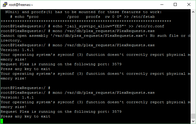

Ok, i re-did everything from scratch and Sickrage was working. Still, the issue that as soon as i close the terminal, the jail stops working, persists.
This is what appears when i start PlexRequests from putty
INCSlayer
Apr 4, 2015
197
zodiac install screen (or tmux) and start it from inside screen and detach it and it should run in the background

Using screen seems to have worked for me. Though, even using this method I still have the memory message that ZodiacUHD posted above. I don't know if that is a jail issue or a plexrequest.net issue. If I run into problems, I will post on the git forum.

I'm having the same issue as this gentleman.
I've spun up a completely new jail and done this from scratch. I'm on FreeNAS-9.10-STABLE-201604140622 (8781269).
My error dump is below:
Your operating system's sysconf (3) function doesn't correctly report physical memory size!
[ERROR] FATAL UNHANDLED EXCEPTION: System.AggregateException: One or more errors occurred. ---> System.Net.WebException: Error: SendFailure (Error writing headers) ---> System.Net.WebException: Error writing headers ---> System.IO.IOException: The authentication or decryption has failed. ---> Mono.Security.Protocol.Tls.TlsException: Invalid certificate received from server. Error code: 0xffffffff800b010a
