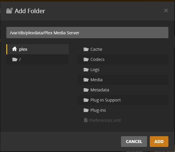

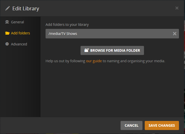

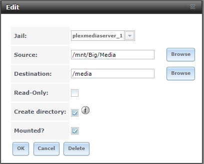

Looks like the bug report has gone private, I think I may have found a workaround or possibly the root of the issue. I rolled back to FN 9.10 and was still getting the same issues. I began to run down the possible changes that I may have made to cause the issue. I began inspecting and one of the issues I came across involved the mapping of the jail storage. When upgrading to FN11.1 my server kept the same Plex settings it had in the past. After reinstalling the plugin I had to setup the Plex libraries again. I had ran into an issue where I could not navigate to the root directory to get to the /media folder inside the jail (/mnt/"poolname"/"datasetname"/"jailname"/media) where people recommend you point the jail storage to. After some toying around I found that when you pointed the storage to the default directory (/var/db/plexdata/Plex Media Server) it would switch the plugin to off. If you drop it to that media folder instead then it seems to run properly. I have attached some screen clips to help explain myself. After "fixing" the jail storage I could load Plex and point it to the /media folder and it worked!!
TL;DR: I changed the jail storage settings and it seems to have fixed the issue so far. I still believe this may be a bug specific to FN11.1. However, there is also an issue where in FN11 you cannot see the root directory for the jail, so you cannot point to the "recommended" /media folder inside of the jail.

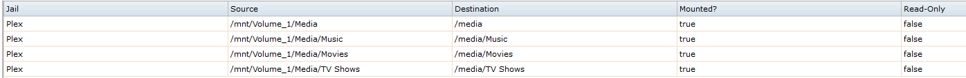

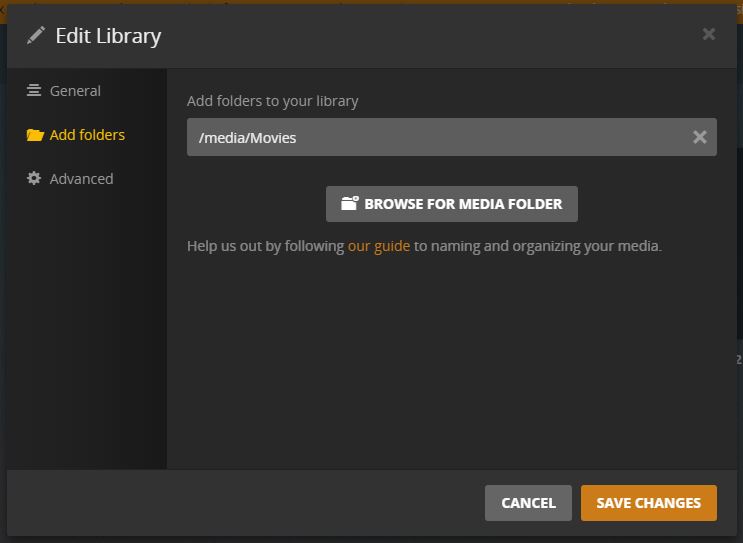

The Storage looks like this:
Plex Library Looks like this:

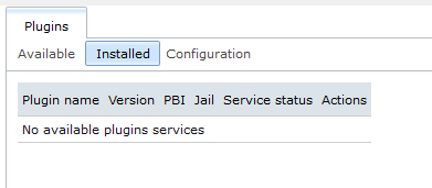

The one issue is that the Plex Plug-In does not come up as installed.
That's because it's not a plugin. You installed in a standard jail (the recommended way) and there is no "buttons" to push in the GUI to start and stop it. If you do need to start or stop use standard service commands from the jail CLI to do so.
