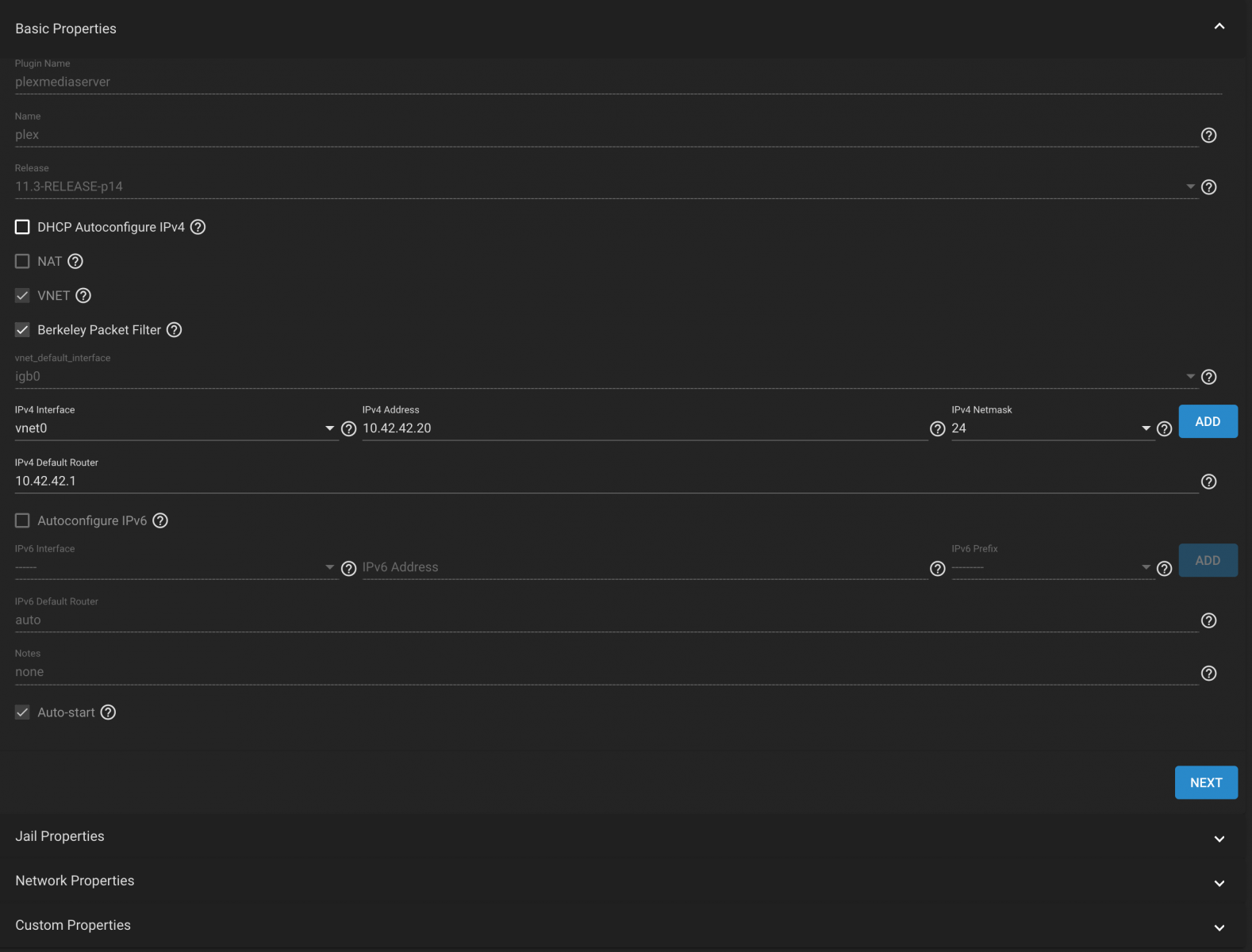

Okay not sure where I found that command but what you sent sounds more right. Here's what happened:
[~]# iocage start plex
No default gateway found for ipv6.
* Starting plex
plex devfs_ruleset 6 does not exist! - Not starting jail
In the GUI under jail properties there's a reference to devfs_ruleset being 6. I have no idea what this is. My other jails all have this as 4 so I changed it to that and now the jail starts but it can't ping anything else on the network (and now that I notice neither can any of my other jails). By the way I'm using IPV4 and have no IPV6 settings anywhere in my network. From the little bit of googling around I've done I understand that devfs was broken on FreeNAS but is now fixed on TrueNAS. I'm closer to working but it's not there yet.

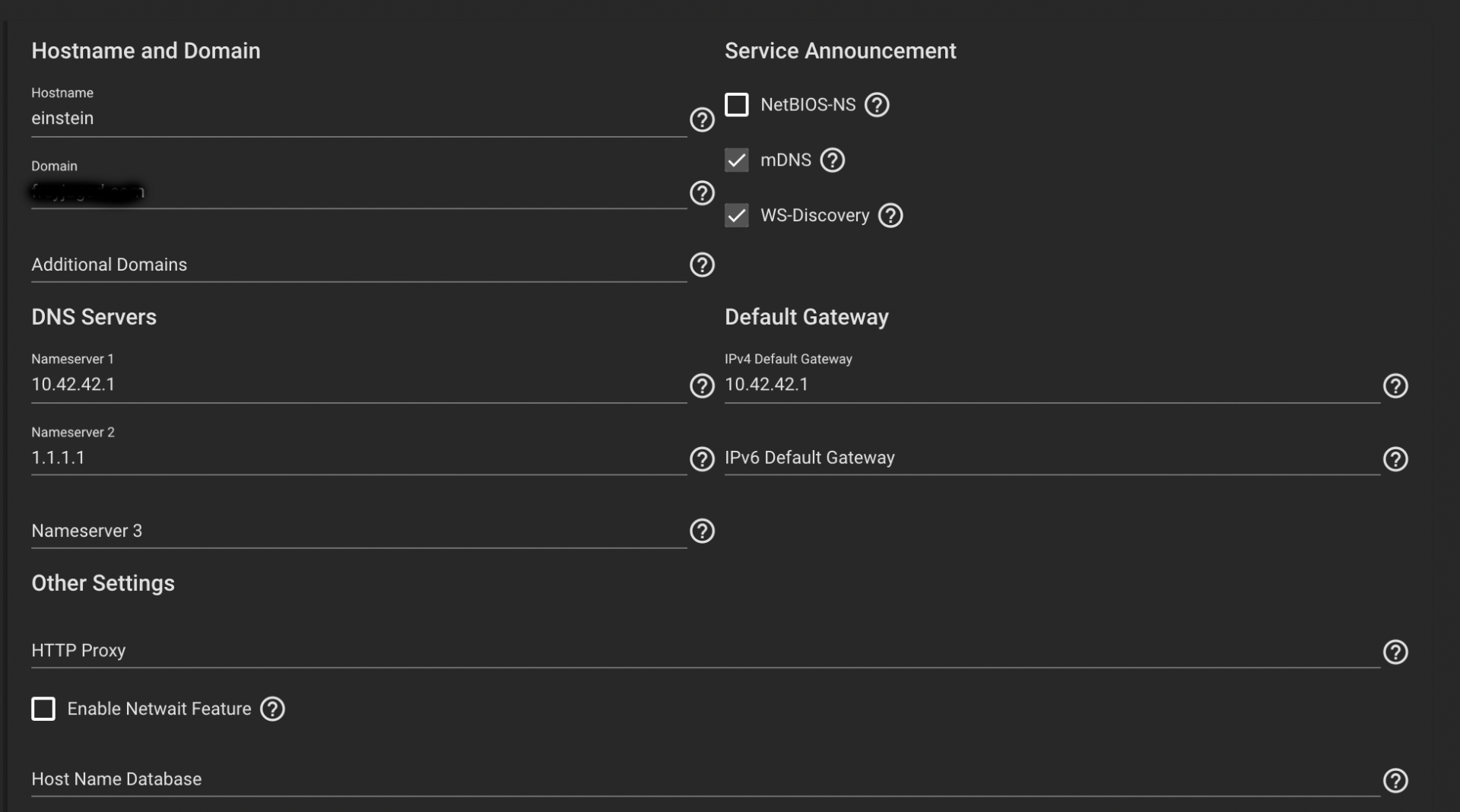

This is likely a network issue. Post the output of
ifconfig
Then show me a screenshot of your settings in the GUI NETWORK>GLOBAL
here's ifconfig the internet is on igb0 and there's a VM hosting a website hooked up to igb3 the re0 and igb1and2 aren't used.:

Can you ping out on the host?
ping google.com
ping 10.42.42.1
If you are able to ping the gateway from the host\ Make sure all of your jails have the correct IP info set, namely gateway and static IP.

From within the jail I cannot ping anything inside or outside of my network. Nor can I ping the jail 10.42.42.20 from anywhere outside the jail.

Right but the host is getting out fine? Doublecheck that you have a defaultrouter setting within the main jail settings of 10.42.42.1 for each jail that isnt getting out.
Jan 7, 2015
1,153
I only asked as you are using your GW and 1.1.1.1 for dns, which is likely ok..

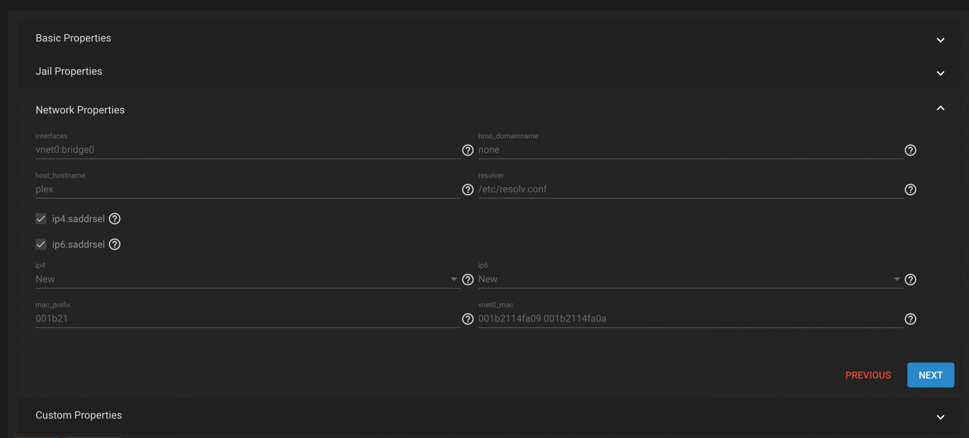

Yes. The host can get on the internet and my internal network just fine. In fact everything works just fine if I go into the UI and select 11.3U5 as my boot environment and restart. That's what's weird. Here's the jail's network configuration if that maybe helps.

Then enter the jail and do (if you are getting out). Do this in each jail (you can also use the GUI, same thing).
pkg update && pkg upgrade
I also dont use Berkeley Packet Filter, and never have. Not sure if you need this or not..
Two things, firstly, I thought you could run a jail as an old version even if the host was on the new version shouldn't plex be perfectly content to run as a 11.3u5 jail until I decide I want to upgrade it?
Youll have issues updating it, but im certain it will "run" fine.. This is on you. I wont stand for a mismatch like this on my system, but your standards might be lower.
The devfs ruleset was an error relating to ip6, we arent using it. Ive never messed with anything else to do with dev rulesets, so not sure.
If your host cant reach pkg then something isnt right.. Your absolutely sure you can ping freebsd.org from the host cli?

Did you disable berkeley packet filter, apparently its only needed when you use dhcp.. I never used it, not sure if it might be blocking that jail from getting out..

I disabled that. Still no good. It's the strangest thing. I just noticed that even though I've got IPV6 disabled every way that I can see in the jail configuration when I go into a shell in the jail it still reports that my interfaces have ipv6 addresses. Could that be related.
Jan 7, 2015
1,153
Yes id think so. Try this from the host cli:
iocage exec plex sysrc ipv6_activate_all_interfaces="NO"
iocage restart plex
