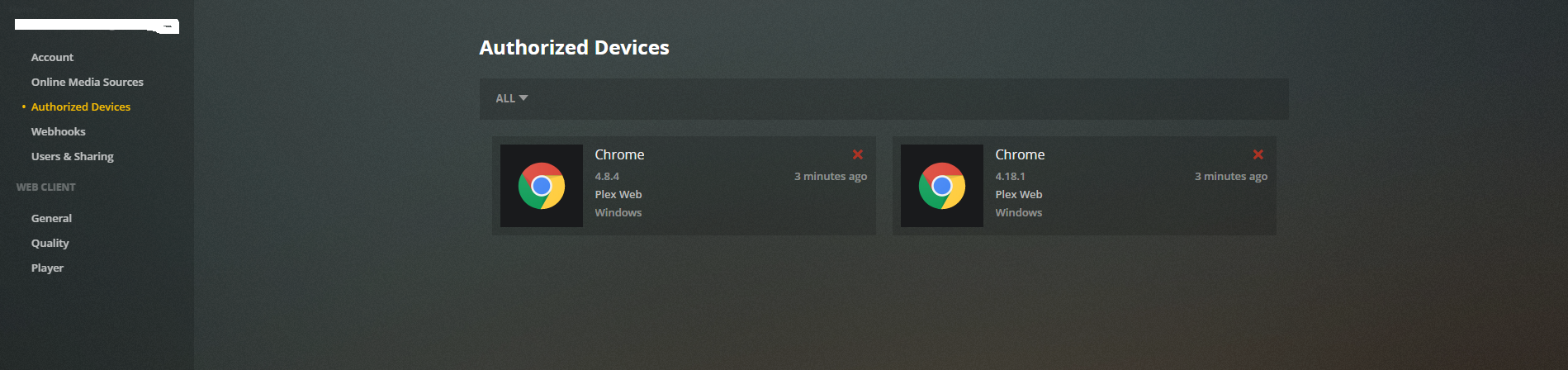

I do log in my account ( and i am logged in) this account is not a plex pass and my old server was on windows which i deleted from authorised devices. When i click management it goes to the correct Ip address (freenas plex) it is logged into the correct account i even logged out then back in restarted freenas etc.. do we have firewall rules on the freenas gui?

Try going into the management page, and in settings. In between Plex Web and Status will be your servers with a drop down menu. Delete the old server and restart the jail.

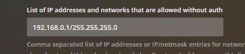

Can you get to the settings page? If so go to settings/network and add your nameserver IP and netmask to the "List of IP addresses and networks that are allowed without auth" box and save.

I'm facing the exact same issue and have been unable to solve it so far.
The settings page does not contain any "network" tab, as shown in hckyan97's thenwhat.PNG screenshot.

I have found a solution for this issue. By default, Plex only allows connections from machines that are on the same subnet. If this is not the case, you need to SSH into the host somehow and add a parameter such as
allowedNetworks="192.168.0.0/24,..."
Then you will be able to continue your server setup as intended.
