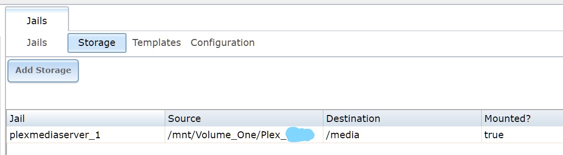

I have mounted my as follows:
a.)
source = /[my SMB share]
destination = /media
Everything works great.
b.)
destination = /var/db/plexdata/Plex Media Server/Media
Everything works BUT no matter what I do, it would not create thumbnails. Not for photos, movie files, anything.
I can put one file into the SMB share, create in plex two libraries and point each at a different "destinations" one at /media and the other at /var/db/plexdata/Plex Media Server/Media and both will show the file, but the latter would not show any thumbnail at all. It'll happily play the movie or show the picture, but no thumbnail.

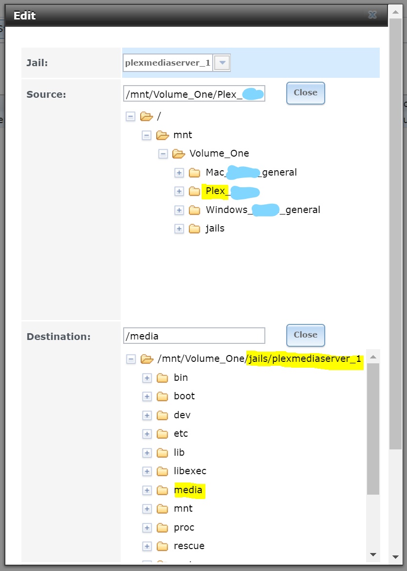

When using a Jail/plug-in, you mount the FreeNAS host media dataset directly inside the jail under Jails > Storage. There is no need to use SMB or NFS. If you are still having problems, you may need to change permissions somewhere. Plex might not have write access.

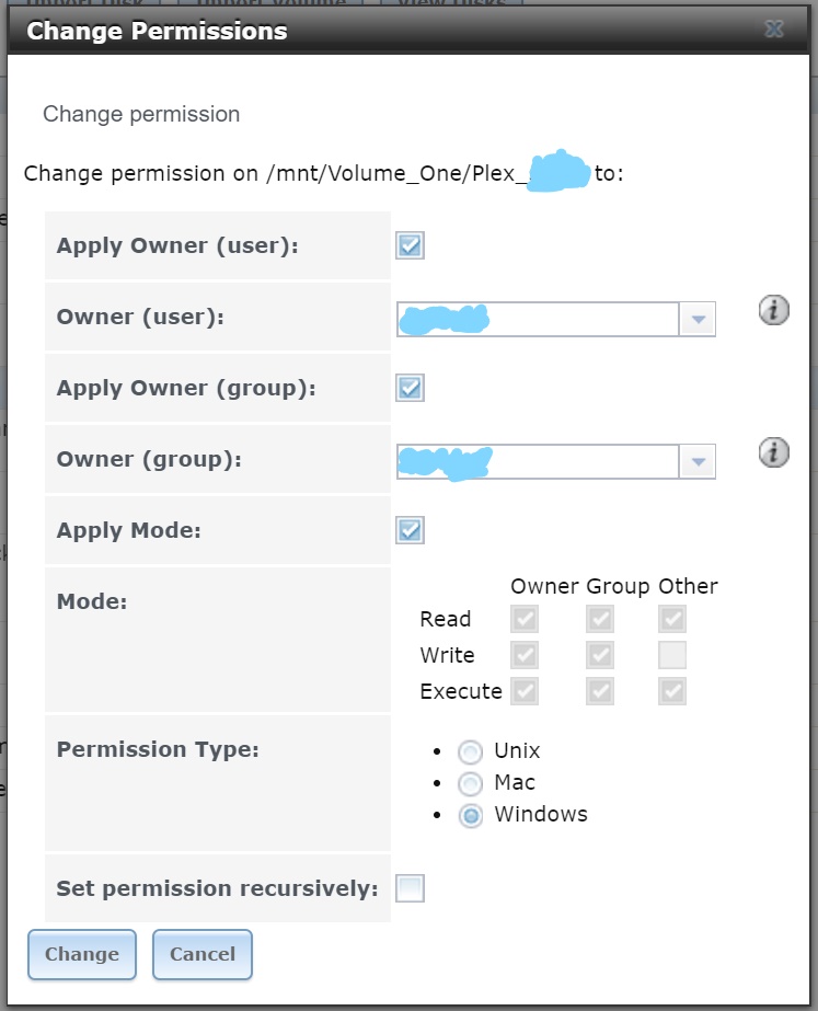

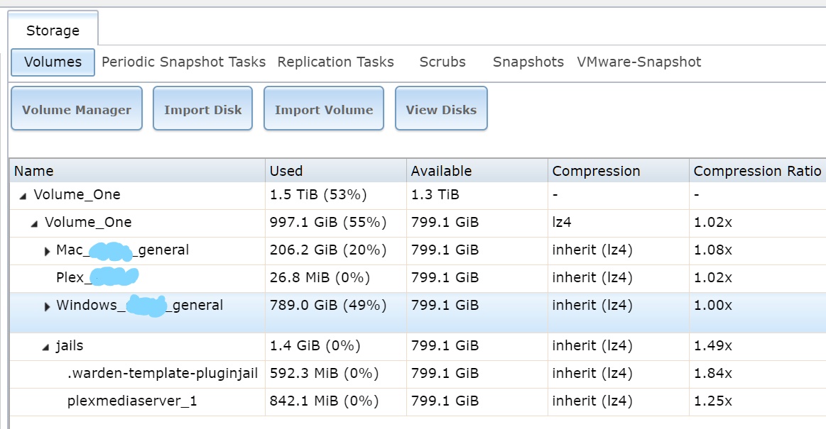

Thank you scrappy. Just to clarify, I am trying to have a folder/thing I can put my files into from my PC, so I've created a dataset (called "Plex_stuff" in the attached picture) and made an SMB share to "Plex_stuff" so I can have access to it from my PC. I then add "Plex_stuff" as a storage for the plex jail (which the plug-in created automatically). Is this the right way of doing it?
From what you're saying, it seems "Plex_stuff" needs to be created inside of the jail dataset? I tried this but I just cannot seem to share it to my PC.
I've attached the current situation. I covered up few items (well actually the words s*it) but the owner and group are basically me and the group just has me in it.

Did you try analysing and scanning the library again? Sometimes thumbnails take some time.
It looks like you have your storage configured correctly.

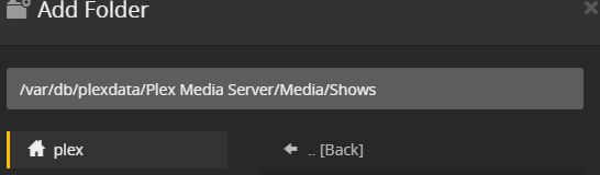

I cannot seem to get Plex to see the data I have mounted in the /media directory. for whatever reason it only will look in "/var/db/plexdata/Plex Media Server/Media/Shows". running Freenas 11.1 and Plex 1.12.0.4829.
