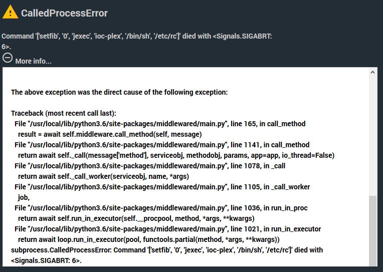

I'm seeing some plex jail issues related to the mount points and it seems to be related to having a space in the source mount point.
In my case I'm mounting /mnt/Data/Media/TV Shows to /media/tvshows
If I attempt to mount it the jail flat out breaks and I get simular errors to...
If I mount any other directory that does not have spaces the problem doesn't seem to occur.
I've now seen this on 2 installations and this problem didn't seem to exist in U2.1, the problem seems to have just started in version U3
I am currently running 11.2U3
Anyone have any idea how to work around this problem?
I've tried surrounding the source with '/mnt/Data/Media/TV Shows' and I've tried /mnt/Data/Media/TV\ Shows
Neither seem to work and usually breaks the jail to the point that it needs to be reinstalled because removing the mount points and trying to start the jail gives me the same error as posted above.
