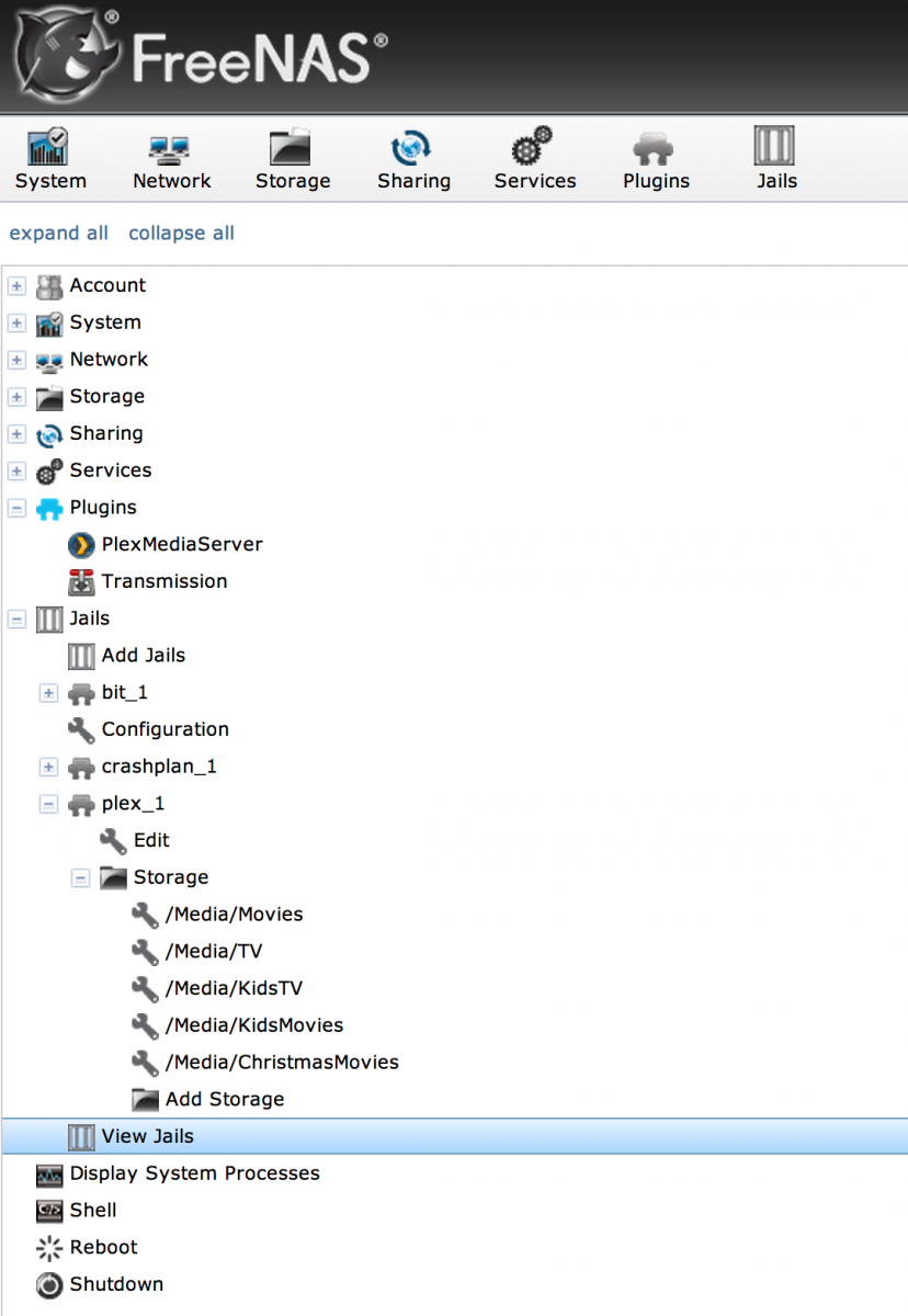

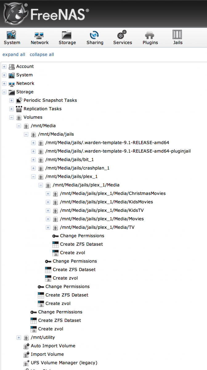

I have created ZFS mountpoints in the plex_1 jail that link to the correct folders (that are working over CIFS for windows just fine) (see attached fn_mounts.png)
and in the jails config, I have added storage that points to the directories (I believe correctly) (see attached fn_jails.png)
If I open the shell and browse to the mounted folders from within the jails\plex_1 folder they are empty.
If I open the shell and browse to the ZFS mounted datastores, they are populated as expected with my files.

so I've done some more digging, and it appears that when I make a zfs mount, that it's just not seeing what inside of it. It's happening on ALL of the plugins I've setup (transmission, htpc manager, pms) so it's clearly something I'm doing wrong. Everything else about this works swimmingly, and I'd even just SMB mount everything but it appears that this version of PMS doesn't support SMB....Anyone? I've upgraded to 9.2 RC to see if that made a difference, it did not.
