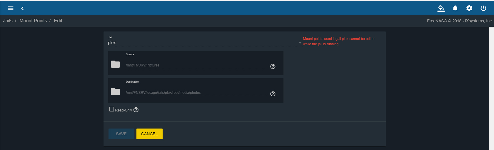

Okay. Had to start from scratch. All of my media files are stored on the main volume in named folders, i.e., Music, Movies, TV, Pictures, etc. Sure, it would have been nice to figure out all the scripts and coding to pop it back to where I was in 11.1 and earlier by migrating but it's taken me less time looking and absorbing strings of characters with/without spaces and punctuation marks since I have no clue what might happen when I hit "Enter" and wind up with a bigger mess than I already had. When I tried a couple of times re-installing FN 11.1 then upping to 11.2. I got to the point where I was getting a bad error every time I tried to install the Iocage Plex so surfing I went again. It seems remnants of the earlier Iocage jail were still hanging on. Since all of my data sets were independent in the main volume, I read a post somewhere about getting rid of the "old" Iocage data set and that was the key. I deleted (with fingers crossed!) and the re-install proceeded successfully. I now have my Plex set up consistently working.
I started FN back in the 9.3 era and had little to no trouble figuring out how to mount the folders properly. But, I think, in about 9.10 the process changed in the Plex procedure where the "Add Folder" started giving you the "wrong" folder tree to start and you had to type in"/media/music" which would the create the folder for you (and their was an implied path BEFORE "/media" which was invisible in the Plex process and would have led you to a better understanding and figuring out which folder was which in that directory. I figured it out eventually.
Now with 11.2, Iocage changes the game once again but not in a bad way . . . just a different way. It uses its /iocage/jail/plex/root/media/ as the mount points which MUST be created in the Jail>Mount points section of the interface with Plex NOT running at the time.
Plex will NO LONGER create that folder for you.; it must be done adding a mount point in your version of the path indicated in "Destination." I did so step by step, entered one mount point then fired up Plex and loaded that folder, rinse, repeat until all my Io cage folders contained the "shortcuts" to the main volume data sets of actual data. Lawrence Systems (who had his Freenas shirt on!) explained it although I did have to view it a couple of times before it sunk in enough into this noob mind.
Caveat: He also mentions about NOT being able to "slash" your way to the path. I'm not sure how he meant that but after a few minutes of trial and error, I think he was referring to the old Plex method of creating that folder. If you notice in that picture above, I was successful using the "media/photos" slash but that was in the "Jails>Mount Points>Edit" in Iocage NOT in the Plex interface! Mount points created the folder in the right place. Once that is created THEN when you do "/media/photos" in Plex it will start populating Plex. Then the rest of your Plex categories as you do them.
If you are trying to migrate your previous warden jail into the new iocage jail with your existing data, I can't help you. I researched and videoed until my eyes were blurring. I had this week off for the holidays and did what I could to figure it out. I am returning to work tomorrow (Jan 2) and do not even pretend to understand the underlying codes and syntax you guys who probably do this for a living have mastered and know like the back of your hand. My hat's off to you guys. I wish I could be you!
And as ThreeDee said above:".. but the new iocage jails are pretty easy to setup and deal with. If I can get things working .. anybody can." He converted me . . . and Lawrence Systems helped a bunch, too.

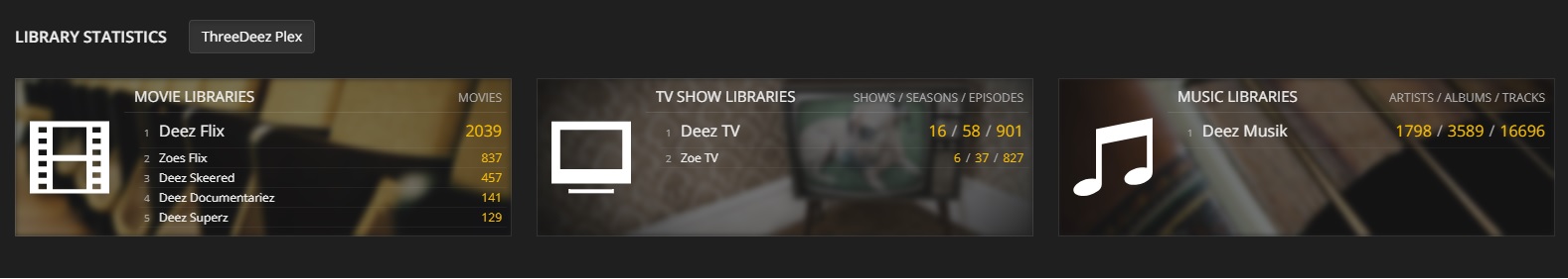

most of my music got the metadata correctly from what I can tell .. even some oddball stuff at least got the artist correctly. I do have to hand select the correct metadata from time to time on my "videos"
