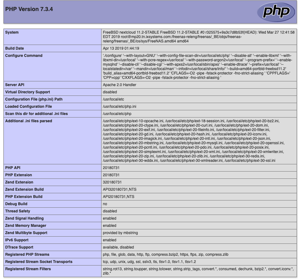

I got 7.3 php up and running as evidenced by php info...
However, the main application in this jail will not start, which is Nextcloud. I am getting the following error in the httpd-error.log
root@nextcloud:/var/log # tail httpd-error.log
[Tue Apr 16 05:19:03.025318 2019] [php7:error] [pid 8804] [client 66.199.23.246:15735] PHP Fatal error: Uncaught Doctrine\\DBAL\\DBALException: Failed to connect to the database: An exception occured in driver: could not find driver in /usr/local/www/apache24/data/nextcloud/lib/private/DB/Connection.php:64\nStack trace:\n#0 /usr/local/www/apache24/data/nextcloud/3rdparty/doctrine/dbal/lib/Doctrine/DBAL/Connection.php(429): OC\\DB\\Connection->connect()\n#1 /usr/local/www/apache24/data/nextcloud/3rdparty/doctrine/dbal/lib/Doctrine/DBAL/Connection.php(389): Doctrine\\DBAL\\Connection->getDatabasePlatformVersion()\n#2 /usr/local/www/apache24/data/nextcloud/3rdparty/doctrine/dbal/lib/Doctrine/DBAL/Connection.php(328): Doctrine\\DBAL\\Connection->detectDatabasePlatform()\n#3 /usr/local/www/apache24/data/nextcloud/3rdparty/doctrine/dbal/lib/Doctrine/DBAL/Connection.php(623): Doctrine\\DBAL\\Connection->getDatabasePlatform()\n#4 /usr/local/www/apache24/data/nextcloud/lib/private/DB/Connection.php(151): Doctrine\\DBAL\\Connection->setTransactionIsolation(2)\n#5 /usr/local/www/apache24/data/nextcloud/3rdparty/doctrine/dbal/lib/Doctrine/DB in /usr/local/www/apache24/data/nextcloud/lib/private/DB/Connection.php on line 64
Clearly there is some connection to the database that I am missing in the upgrade to 7.3, but I cannot figure out a location to correct. If you have any ideas, I would appreciate it.
Jailer
Not strong, but bad
Sep 12, 2014
4,975
Does nextcloud support php 7.3 yet? I've heard some developer chatter on other platforms that php 7.3 is quite different and requires a lot of coding changes for existing software to be compatible with it.
