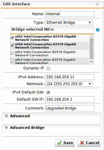

You need to put Sophos in bridge mode. Transparent Bridge mode is best.
I have my Sophos UTM set up behind my Edge Router Lite.

Thank you very much @pirateghost! I thought I had looked through every setting but I seem to have missed that one. I'll try it out, thanks.

just go into 'interfaces and routing', 'interfaces' and make your 2 nics a bridge, and give the bridge an IP in your subnet, so you can manage it.
