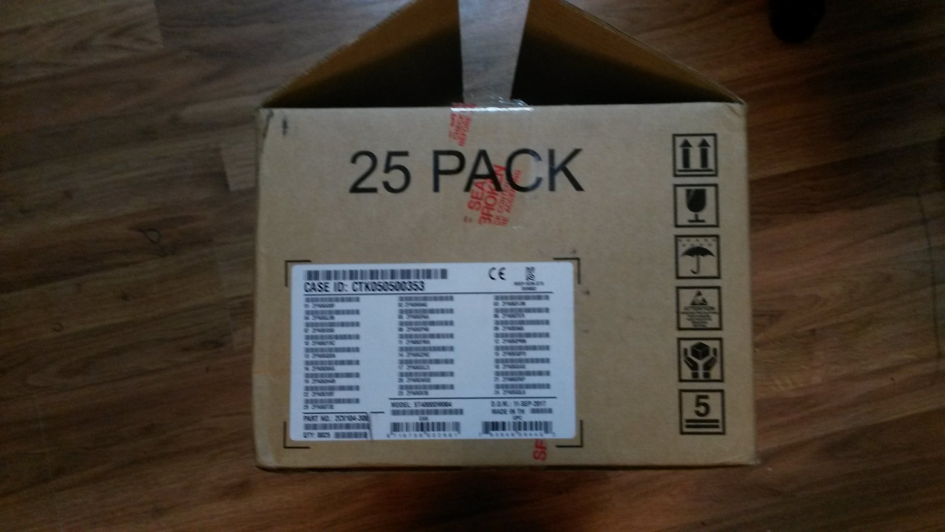

It is a different model, but I will chime in with my personal Toshiba drive story and you can take it for what it is worth. Around the middle of 2017 I was looking to replace one of the vdevs in my home NAS because the drives in that vdev had been migrated from an even older system and were over five years of age and had been failing with some regularity. It is a six drive vdev that was made of 2 TB drives and I simply wanted newer drives, not to expand capacity. I purchased eight (so I could have spares) Toshiba drives like this:
https://www.newegg.com/Product/Product.aspx?Item=N82E16822149407
They were, at the time, the least expensive 2 TB drives available. I did not expect great things from them but they did exhibit better performance than the drives they were replacing, except for one thing. Within three months, I had three failed drives. That is a higher failure rate than I have ever seen with any other model of drive. It put me right off the Toshiba drives and I went out and bought a different brand of drive. Apparently, these Toshiba drives had already made a name for themselves because I had a very hard time selling the ones that were still working on eBay. I lost about $25 each on them after less than six months. The replacement drives have given me no trouble at all, not even a high fly write.
If you want to give Toshiba a shot, go for it, but I wouldn't. I went with Seagate drives, this is the case (empty now) that I bought: 20180813_190918.jpg
