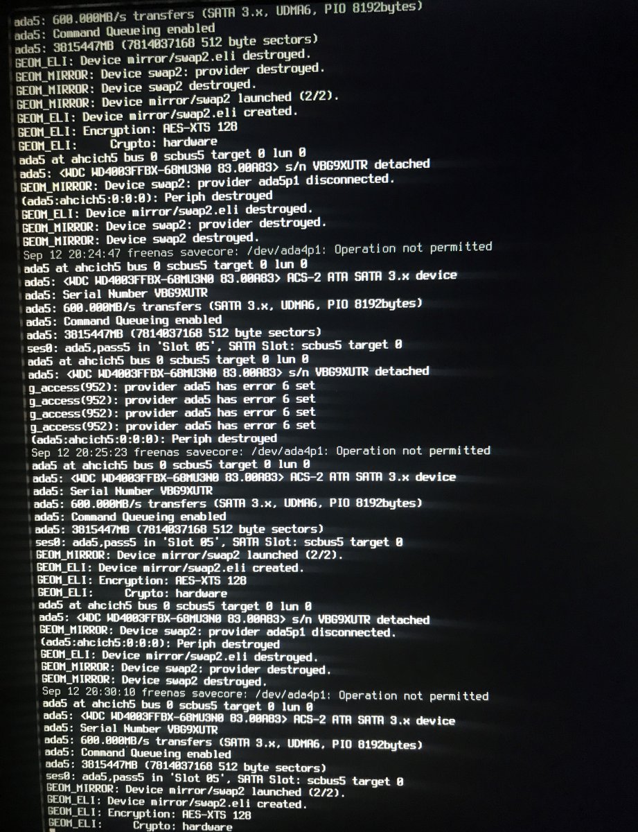

Then I started getting this errors:
I even opened bug ticket as I thought it is software error, rather than hardware one. I got a response to check all sata cables, unplug and plug them. This is when I got unrecoverable errors. After I mixed, unplugged and plugged in the sata cables to drives and boot up the machine I almost lost the pool. It went from healthy to degradaded with 2 drives removed from the pool. I replaced one, but WD drive was getting kicked out of the pool. So I replaced it with new Toshiba P300 drive I got from warranty claim and same errors happended. The drive was kicked out of the pool as well:

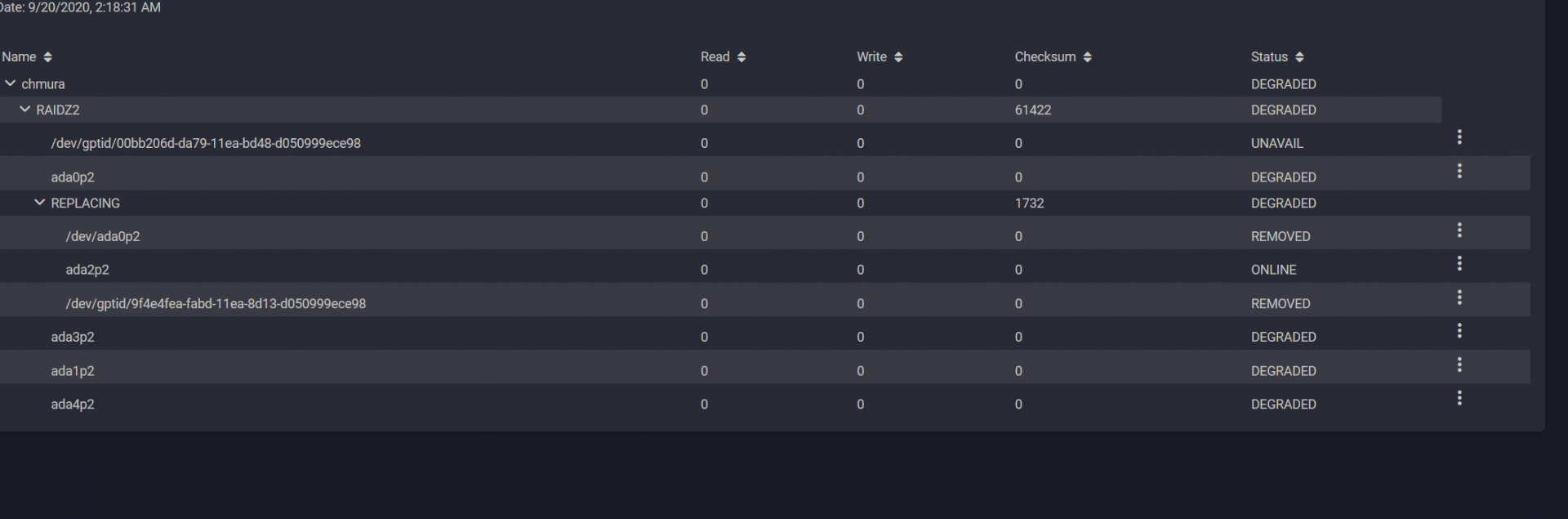

I am just not sure what to do anymore. It doesn't look like hardware error anymore to me, at least when it comes to drives and sata cables. This was brand new Toshiba drive removed, with new sata cable. I don't think I can be that unlucky in terms of drives, from 2 separate vendors. This is what GUI is showing up:
Do you have any ideas how can i troubleshoot it and make my pool healthy again? I know I can't fix the unrecoverable error (I had to delete snapshots, also wanted to change whenthey are done and forgot about it, my mistake I know) but I want to prevent future errors. I am suspecting maybe MOBO has some problems with that drives? They are all connected to SATA ports on MOBO. I am thinking on buying HBA card and connecting the drives to it. Do you think it might help?

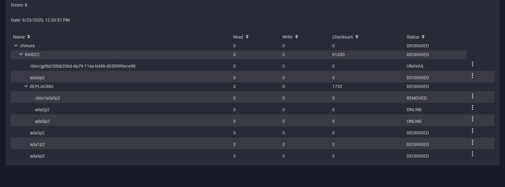

Ok, It looks like that I might be just that unlucky with drives. I added another one and it seems fine.
Now, as for corrupted files. Can I check any logs how they got corrupted? Is my only option to delete them?
