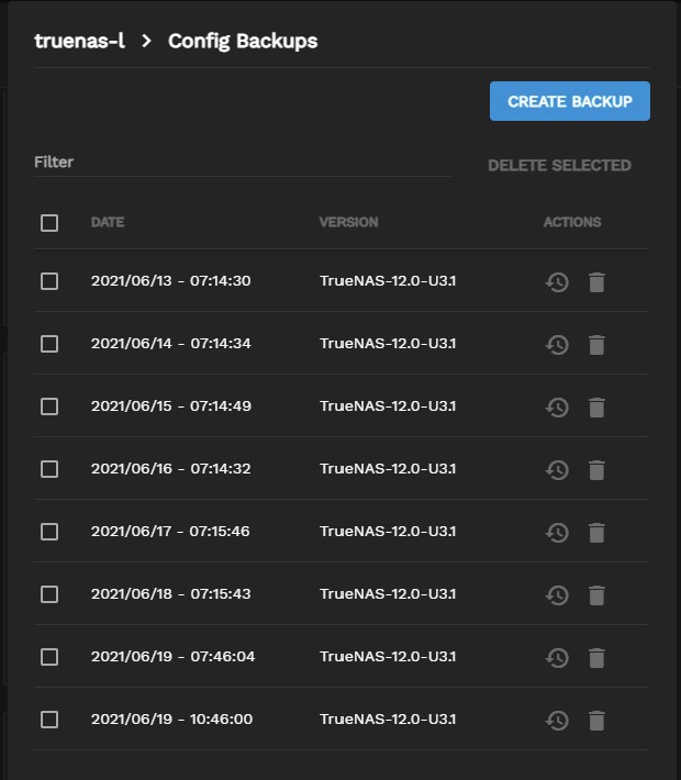

Up till recently, I've been using edgarsuit/FreeNAS report for reporting and config db backup. Unfortunately, the latter appears to be broken under TrueNAS 12. I've logged it as an issue, but so far there hasn't been any movement on it. It's a resource that doesn't appear to be regularly maintained. I still use this resource for reporting, but as I have TrueCommand already set up, I now rely on that for automatic config backup. It does a daily backup of the config db. Below is a sample screenshot.
