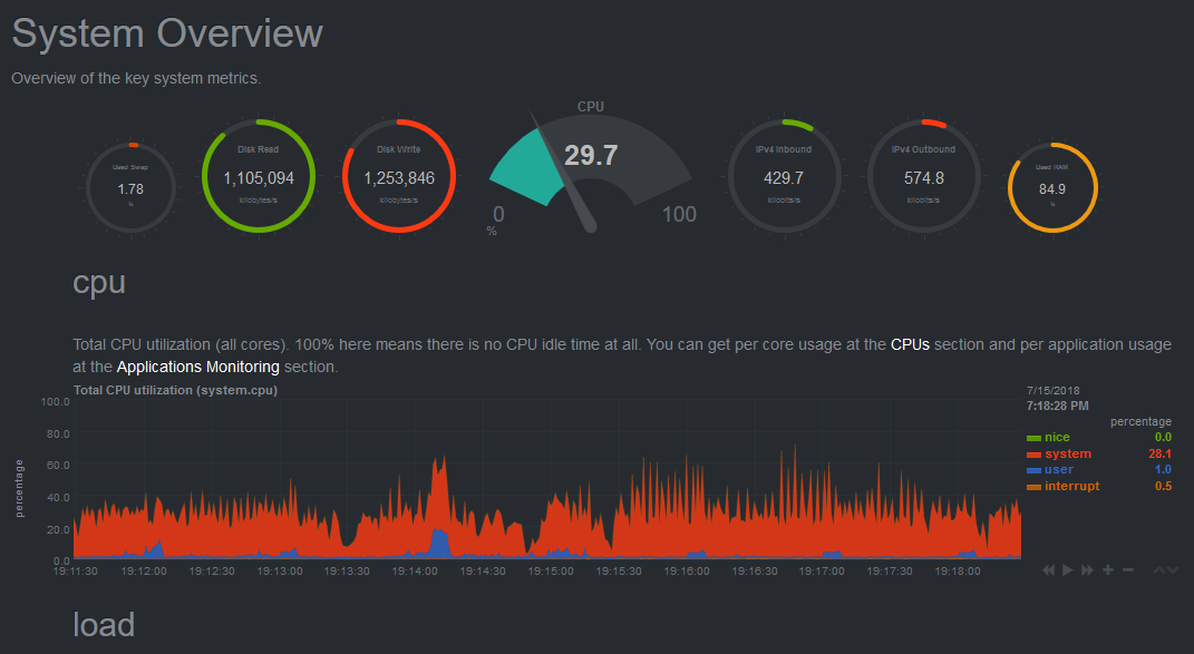

I thought I would share this with you.
Working my system as hard as possible with regard to disk access, the CPU utilization is fluctuating between 30 and 40%.
The CPU is not usually where the bottleneck lies with FreeNAS.

Thank you, What application are you using to obtain this info/graphic?
In FreeNAS 11.1, there is a service called netdata. I don't think it was available in previous versions of FreeNAS, but don't quote me.
http://doc.freenas.org/11/services.html#netdata
