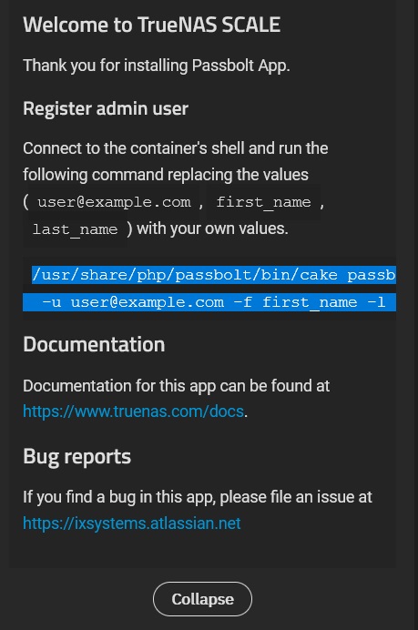

Just in the process of setting up a scale nas, and currently playing around trialing apps, before all the parts arrive, and i really like the idea of a self hosted password manager, and the only one i can see at the moment is Passbolt.There seems to be little to no guides on youtube, these forums or even passbolt forums, specifically, installing it on scale, they typically reference other OS'.
Theres a small box on the right of the app's page, at the bottom, that says to open shell and add a line of code with your name & email, so you can log into the UI, /usr/share/php/passbolt/bin/cake passbolt register_user -r admin \ -u user@example.com -f first_name -l last_name, but half of it may be cut off by the UI so not sure if correct!!
but i tried it in the shell of both containers (theres root & nonroot containers from what i can gather), and it just returns thats it not valid command. Personally think adding these credentials to the Apps set up page would be MUCH more user friendly!!

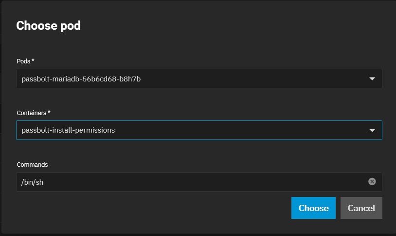

Yesterday I had a hard time getting PassBolt to work in the same phase as you, but I managed to get it working. These are small instructions that aren't included in the "how to", but which make all the difference. I'll try to be brief and clear:
1) When you access the Shell, under PODS you will have two options, the pre-selected one that has "mariadb" in the name and another option. Choose the option without "mariadb".

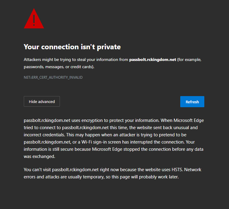

when i go to the link for passbolt this is what it says. no matter the browser i am using.

This error is about the certificate and not the passbolt.
Can you open the properties of the digital certificate via the browser? what information appears?

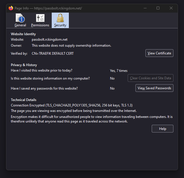

all it keeps saying no matter the browser that it is self signed even thou i have it pointing to the cloudflare cert within the options on the app on truenas. can not actually see any info of the cert itself that it is trying to use. nevermind, i ended up finding it. here is the info.

i did send you my email. now here is the update. on a separate machine i installed ubuntu 22.04.3 LTS. this is the desktop version. through docker-compose. i worked one by one until i finally got it up and running with the domain. i have no issue in leaving it on this machine however, i would like to get it on my truenas as well as to get the dang mobile app to work.
