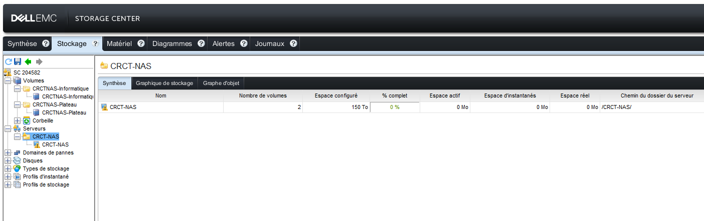

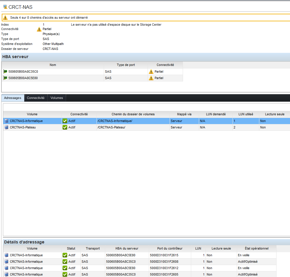

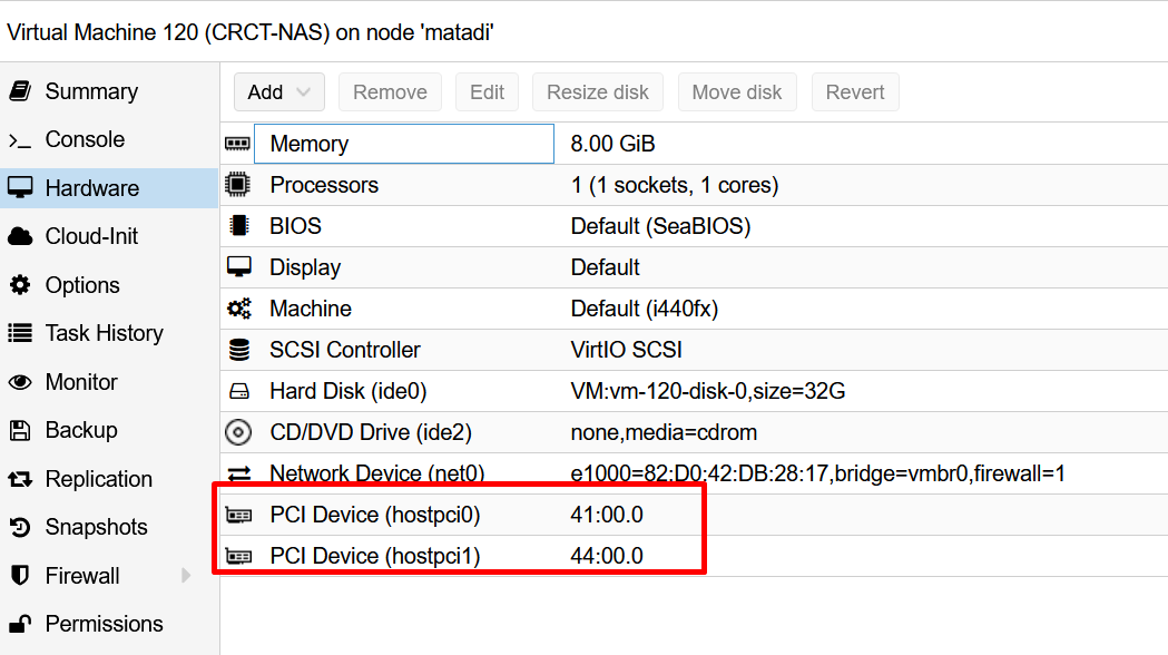

I am running the latest version of TrueNAS on a Debian 10 VM hosted on a ProxMox server. I want the disks used on TrueNAS to be taken from our Dell Storage Center SAN. For this purpose, I've passed-through my Dell's SAS HBAs to my ProxMox Server, along with two 75Tb volumes to go with it that will be used for SMB shares:
(above image is my ProxMox Server (CRCT-NAS) in our Storage Center Client)
(above image is my SAS HBAs passed-through to my ProxMox Server along with the volumes)
(above image is my HBAs passed to my TrueNAS VM in ProxMox)

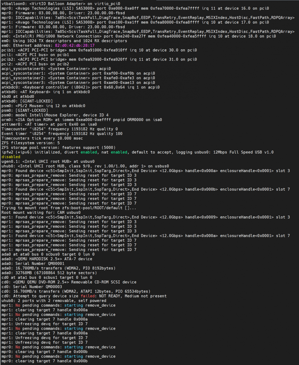

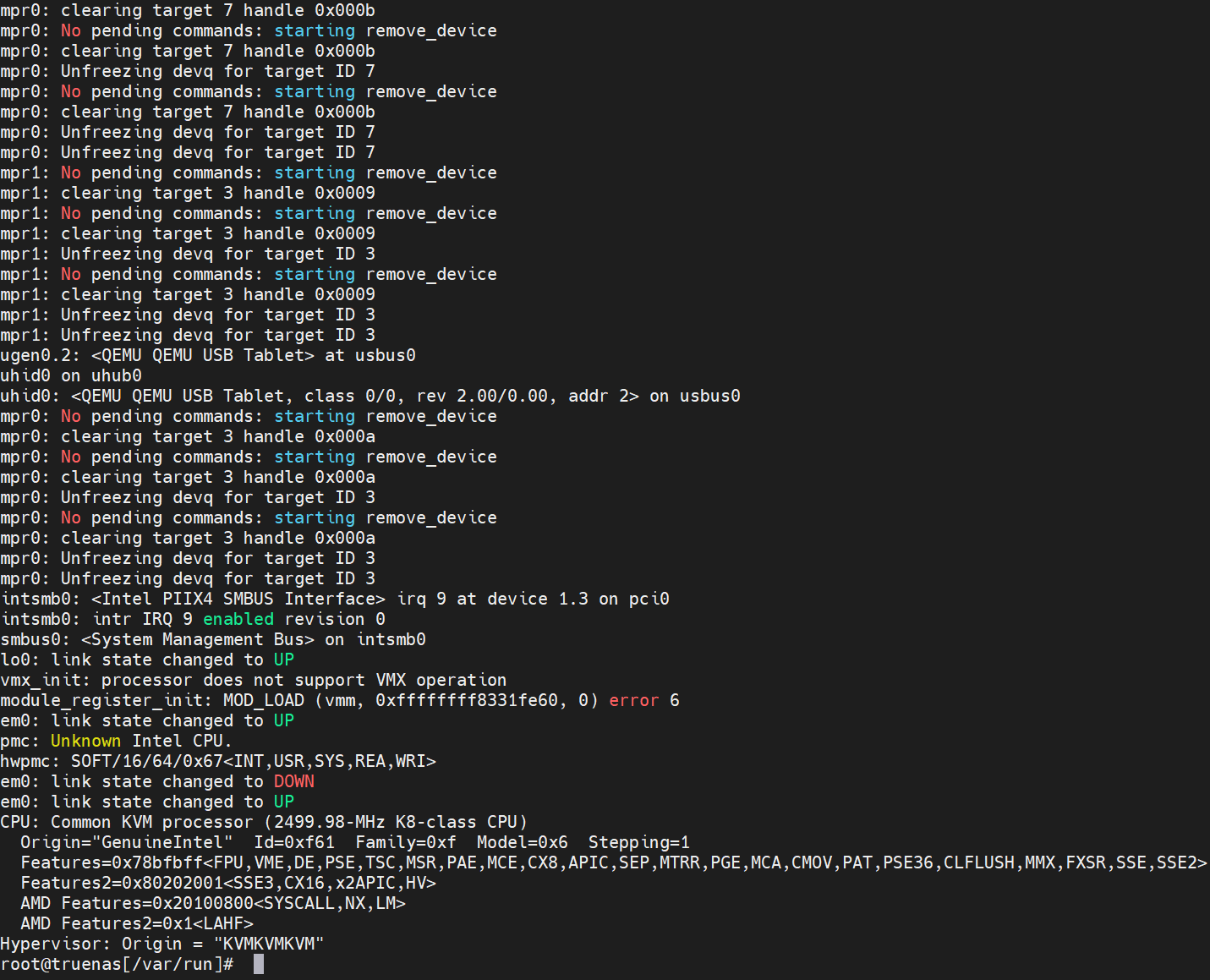

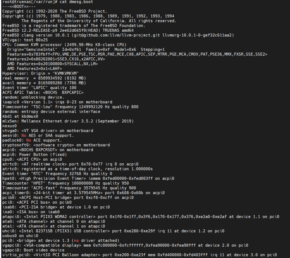

Reading different posts on this forum, I tried this command in the TrueNAS Shell, but have no idea what the output means, just that it's related to disks on boot:

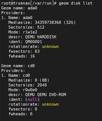

This command that lists disks shows that the volumes haven't been detected:
