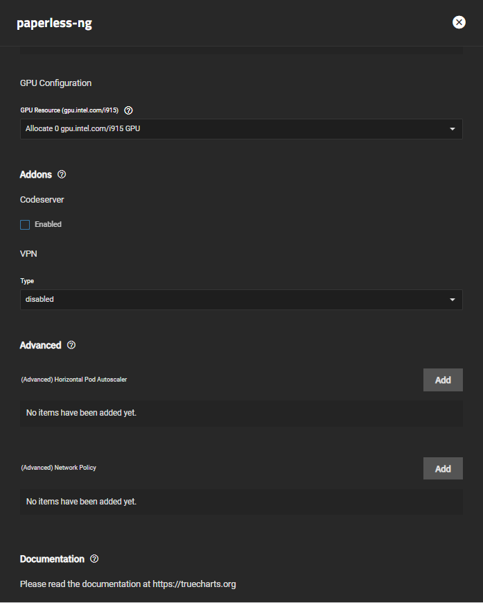

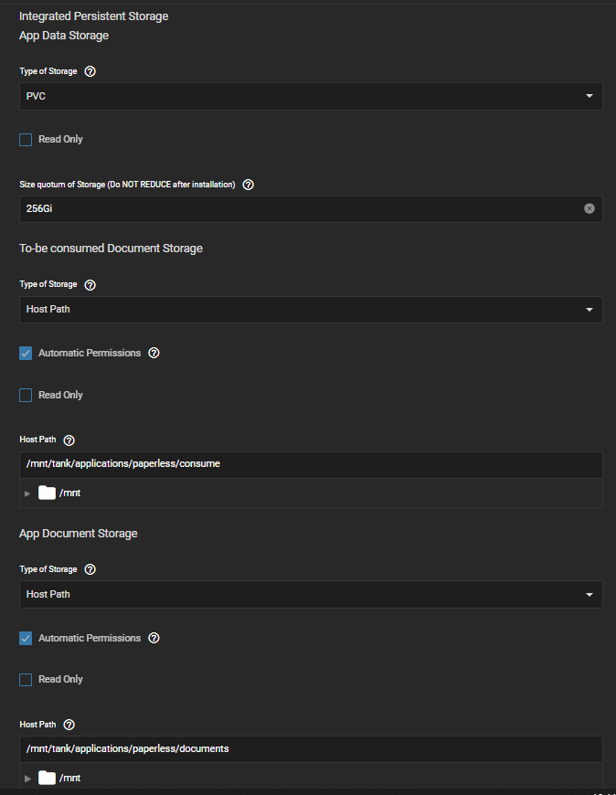

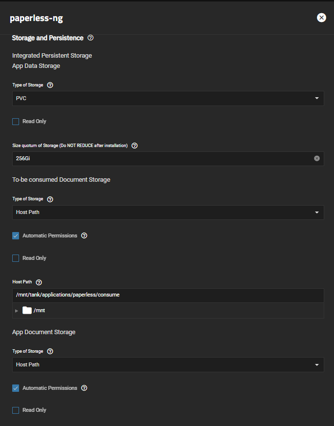

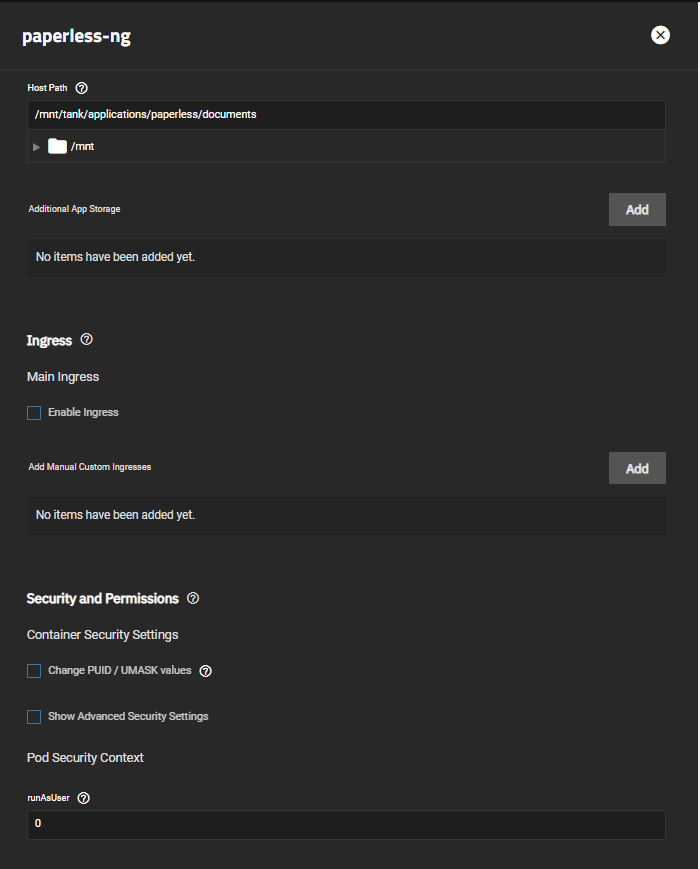

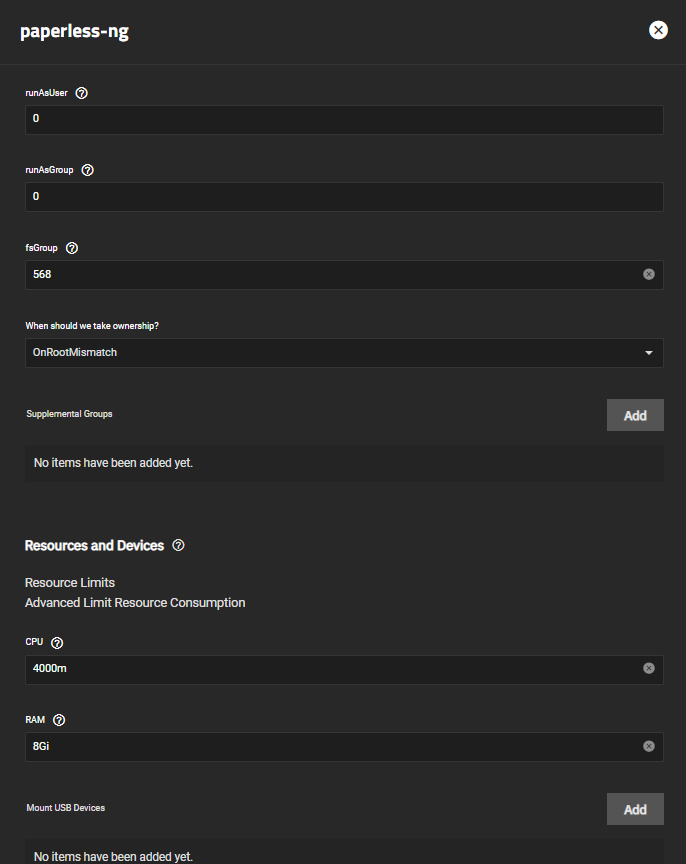

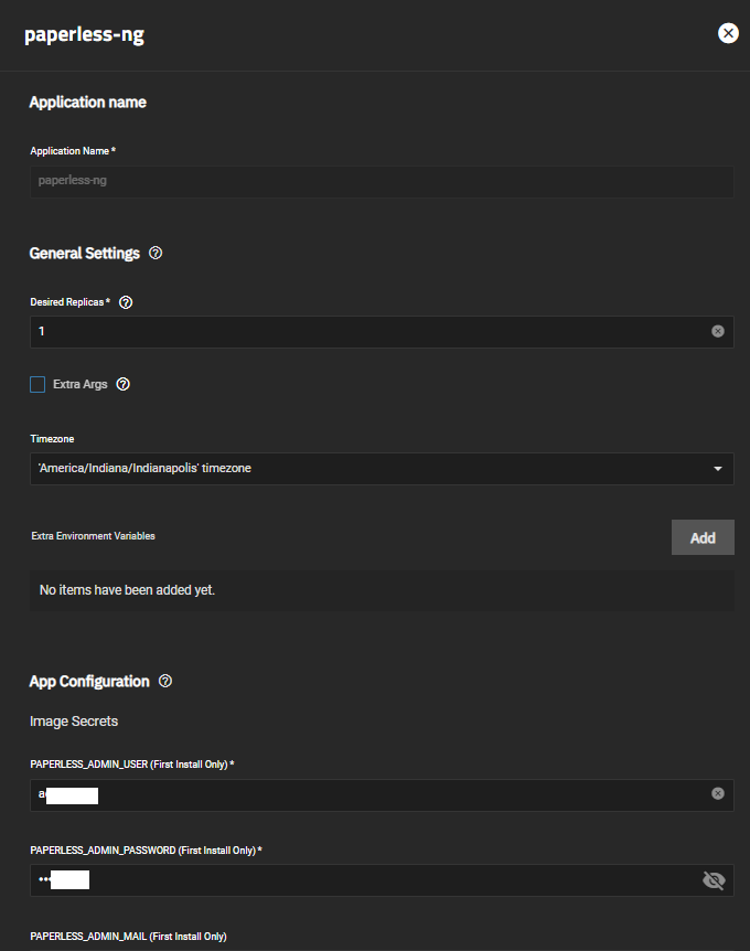

TrueCharts paperless-ng? Mine works fine - no complaints. I can post my settings if needed.
Thank you. Yes. Please do post the external app settings from the TrueNAS UI.
I'm sure it will work again from a fresh install. But, maybe I can revive with some settings adjustment that happened.
Restoring the documents into a new install can be done. But, it's a PIA. Hoping to avoid! :)

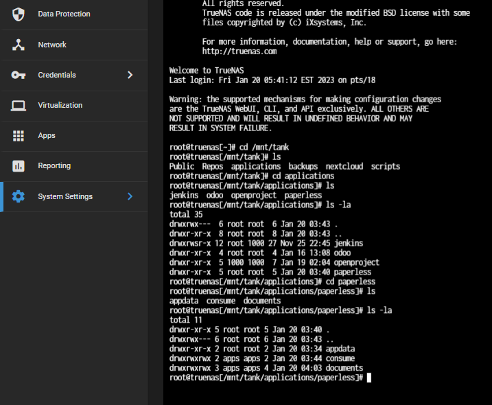

browntiger
Oct 18, 2022
58
You should be able to reconfigure it without any effect on the data or documents.
I know my permissions are too loose 770, or even 750 would have been fine.
Thank you. I think my permissions are ok as they were working for about a year before the Bluefin update.
Can you share the other settings on the app page? I have seen those require adjustments before. So, I'm wondering if that's what happened this time...

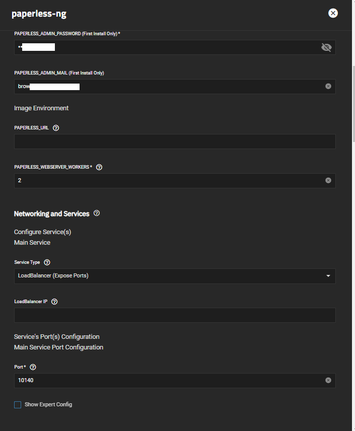

Sure but it is all standard stuff. It looks like @truecharts completely redesigned and revamped their app.
I can not recognize it. I thought I forked it just a few weeks back. :cool:
Here it is LOL https://github.com/truecharts/catalog/tree/main/stable/paperless-ng/
Check your postgresql and the permissions... There is not much to go.
May be there is some sort of issue with postgresql, shell to it or check the logs
But here are my settlings

indivision
Jan 4, 2013
806
Thank you. It looks like mine were already the same.
I ended up re-installing with the same settings and it works again. Though, a few of the largest documents that it had processed before will no longer process. Maybe the file size limit setting was changed in that over-haul?

Maybe actually contact the support staff of the project building your App...
browntiger
Oct 18, 2022
58
@impestrator, Your paperless-ngx postgres container looks good. No errors. Your are missing paperless-ngx pod btw.
To search for an error open shell cd /var/log/, find k3s.daemon.log; see (tail -100 ) if there is an error that relates or it may direct you to a log.
Check the log cd /var/log/pods/ix-XXXX,
But like @truecharts said (visit TrueCharts Discord https://discord.gg/tVsPTHWTtr) and give them a try.

I´ve also checked /var/log/pods/ix-XXXX. I´ve got two paperless folders starting with ix-paperless, but both are empty.

I also checked the application events and found that:
error killing pod: failed to "KillContainer" for "paperless-redis" with KillContainerError: "rpc error: code = Unknown desc = Error response from daemon: No such container: ac53a045ea79b143f95560064693f1aa91fea3e8b1137ce24af5e18916d08e74"
And I noticed a
Startup probe failed: dial tcp 172.16.7.167:8000: connect: connection refused
in the application event
edit:
Well, I was able to make the container running, but I´m not able to reach the web front end. No matter network config I choose. Any suggestions for best practise?
I´ve created a support ticket over a week ago, but it seems that support team cannot help. The webUI of paperless is still not reachable and telnet to IP Port does not give a response. I get replies for ping request and paperless itself consumes files.
All other applications work, even when I create a new paperless instance. So I assume that there is somthing wrong with the webserver.
I really appriciate your assistance.
