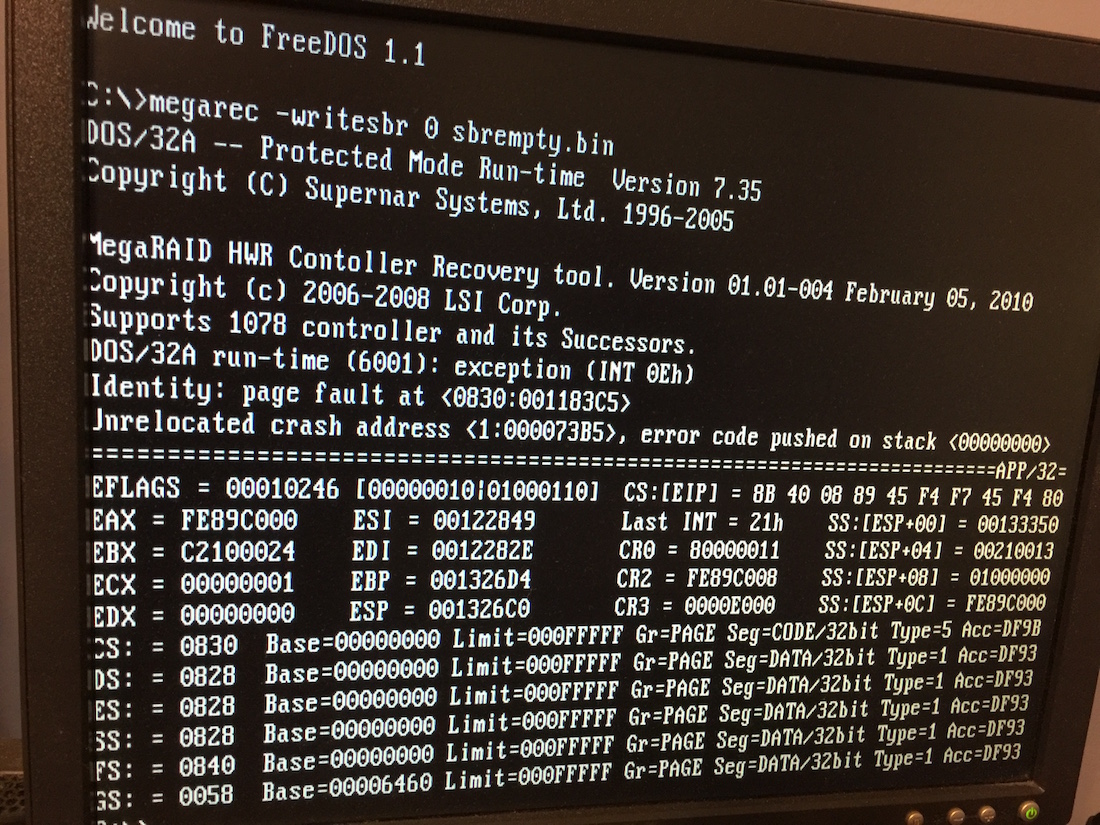

Can anyone help me resolve the page fault shown in the screenshot? I'm attempting to erase the current firmware on an IBM M1015/LSI 9211-8i HBA card.
Look at my signature block for a description of the hardware I'm running FreeDOS on.
Any advice for fixing this one?

Use FreeDOS with as little crud as possible. You want it to look as little as possible like a real OS.

I'm happy to report that my spare IBM M1015 adapter has been successfully flashed into IT Mode with LSI BIOS version P16. I am using a FreeDOS USB boot image from here:
http://www.chtaube.eu/computers/freedos/bootable-usb/
...and he recommends loading FreeDOS without any drivers (option 4 on his boot menu.) That was what I needed to do, select option 4 instead of option 1.

I had a similar experience flashing the BIOS on my X10SLM+-F. It would mysteriously fail when the default FreeDOS environment was booted. Using a barebones environment provided along with the main one, it went without a hitch.
