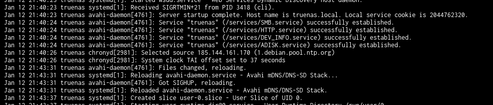

Does anyone have ideas on how i could debug what crashes the os when i touch a specific file in encrypted zfs share
what works mv in the same directory(rename)
what does not:
- mv different dir
- cp
- cat
what happens when try it,
instant reboot, nothing is logged in journalctl in the last moments of the OS
bornav
May 22, 2022
8
additional notes, running scrub on the share completes normally, no issues
drive have no errors, manually running smart, everything normal

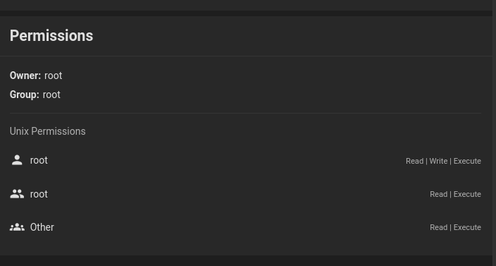

Did you manually change the permissions on the top-level root dataset by any chance?
Otherwise, this would need to be submitted as a bug with a debug attached to the ticket. (Since the underlying issue could be something lower-level.)
