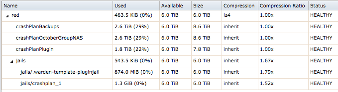

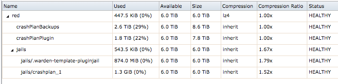

I have a single ZFS Volume, /mnt/red, shown below:
  • crashPlanBackups
    The old CrashPlan Destination built up over the last year using FreeNAS as a AFP Share
  • crashPlanPlugin
    The new CrashPlan Destination created in the past few weeks while testing the CrashPlan Plugin.
What I want to do to crashPlanBackups is

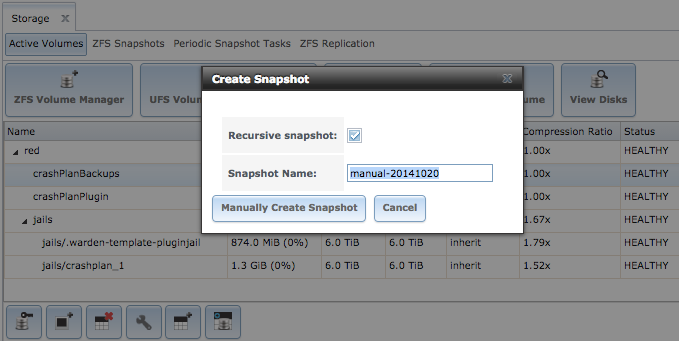

  • ZFS Snapshot

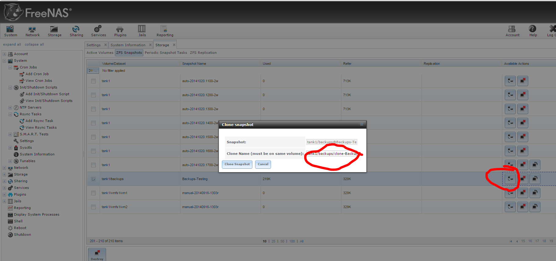

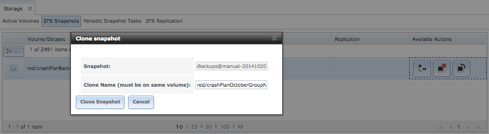

  • Clone

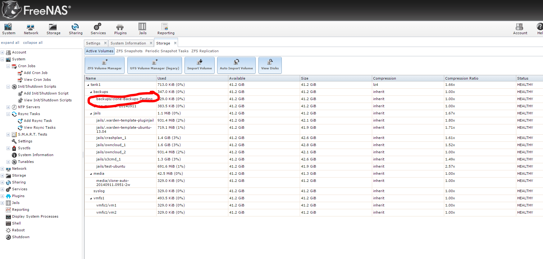

Which yields a third Dataset, crashPlanOctoberGroupNAS

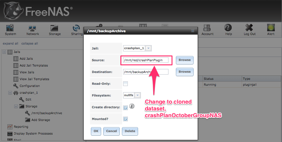

And now, update the CrashPlan Plugin Jail to point to the cloned Dataset:

After you take the snapshot, go to the ZFS Snapshots and select the snapshot you just made, then click "Clone" icon on the right side of the row. Name the Clone.
Now you can test the clone.d volume When done, destroy the cloned volume.

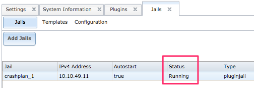

I can't get the CrashPlan Plugin to start. Yes, I've tried going back to the old Jail Storage settings as well as rebooting FreeNAS.
In all the configurations I've tried, the Jail reports that CrashPlan is running:
But the Plugins report that the CrashPlan is off. Even if I turn it on, once I click on another FreeNAS window, e.g., Jails again (above), this Plugin shows the service off when I return to it.
Why are the Jails and Plugins reporting a different status for CrashPlan?

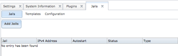

Sorry, after deleting the CrashPlan Plugin, I don't see any evidence of a Jail
