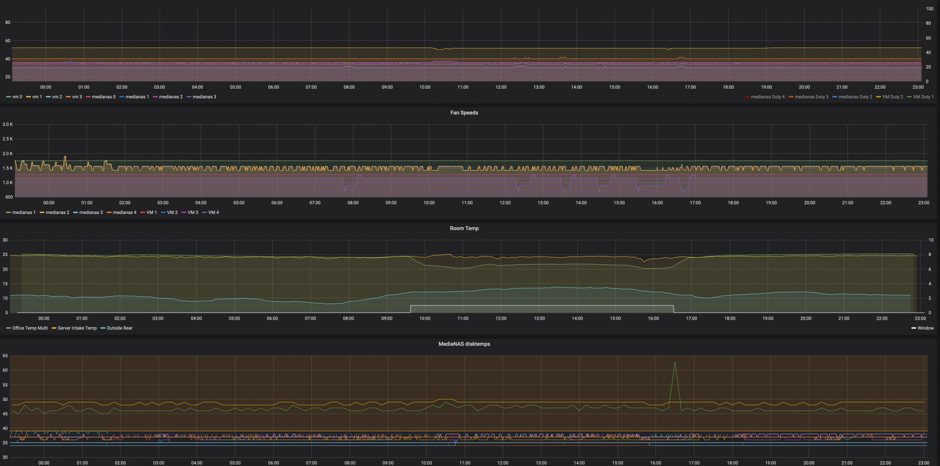

Just to give a little idea about how the script can work, here's a snapshot of the grafana page I have which uses the influxdb output from my version of the script.
Those higher lines on the disktemps graph are NVME drives in that box, so don't have any relationship to the fans, but you can see clearly when there's load on one of them there.
