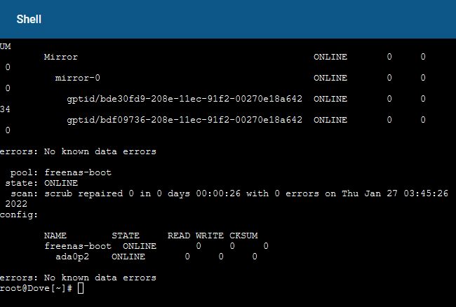

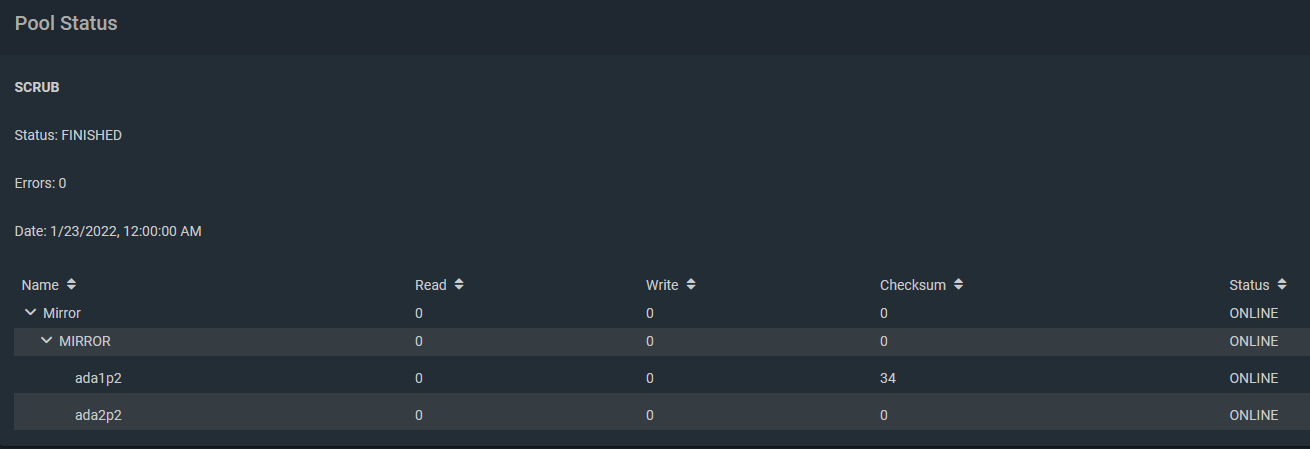

In the shell type zpool status
or Storage / Pools / Click the Cog and select Status
Should give you a display like
djb
Nov 15, 2019
76

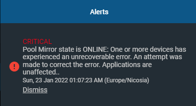

Thank you for your direction. Both operations show the number 34. But everythying is online. Do you think there is a problem on this pool ? is there any way to further test this zpool ?
NugentS
Apr 16, 2020
2,947
Chksum errors often point at a cabling or possibly power issue. I would swap the cabling around and see if the problem transfers. "Zpool clear" can be used to clear errors, but be aware that you may just cover up a problem
