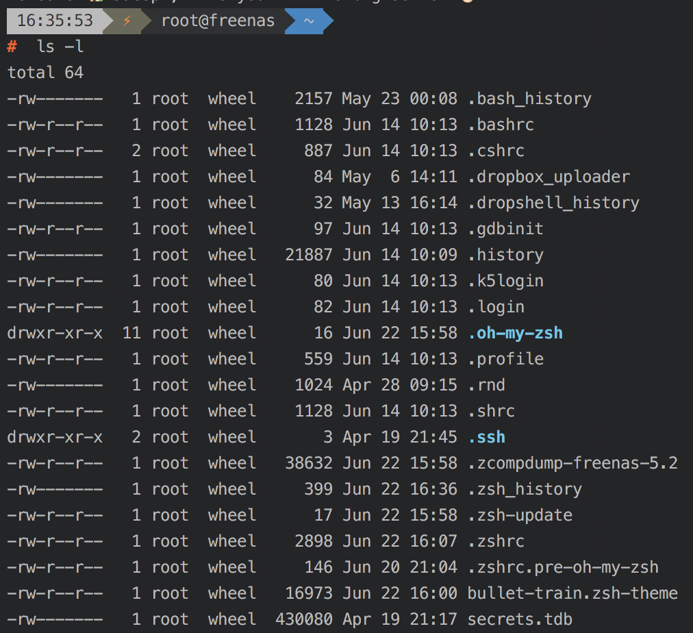

Buonasera a tutti,
I'm using ZSH on my macOS, Raspberri Pi, Linux and other machine... I already use ZSH in my FreeNAS environment and I like to add the oh-my-zsh "plugins" is there anyone that have already tried to do this? :)
oh-my-zsh: https://github.com/robbyrussell/oh-my-zsh
Jacopx
Feb 19, 2016
367
UPDATE: I've tried to install omz in a jail and everything goes fine... Looking at this positive result I decide to install on the main system to and it's properly works! ;)
I use ZSH + oh-my-zsh + iTerm2 on macOS ;)
Here a screenshot:
