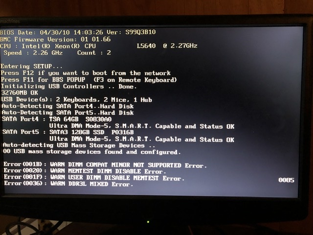

I have two L5640 processors installed on my FS12-TY. After installing 18x8GB sticks of PC3L 10600R-09-10-E1-P1 RAM, I can see only 96GB into BIOS. I have not installed yet FreeNAS, I'm just wondering why I do not see all memory?

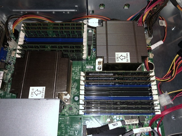

I checked my memory and is dual rank 2Rx4 PC3L. It should see it, I’m using 18 identical sticks. When I’m adding 3 more sticks into the appropriate bank, I get this error:
I looked at the C2100 documentation and inserted the 3 additional sticks into appropriate sequential banks. Anyone knows why I get this error?

@Mirfster I tried every possible and impossible combination, the middle bank DIMMs are ignored. I’m losing 6 potential slots with precious memory. If I move the sticks from C0-C1-C2 bank into B0-B1-B2 bank (middle), they are not seen anymore. I even changed the motherboard, thinking it is defective. It has to be an explanation why the middle banks are not registering the memory.

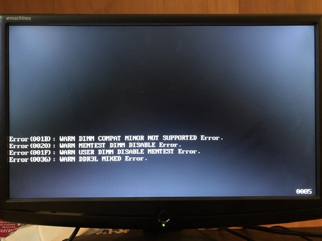

Memory is not seen into B0-B1-B2 and E0-E1-E2 banks:
I can change the size of sticks from 8 to 16GB into any memory bank except middle ones, they are seen properly. As soon as I move or add any memory into middle banks, they are not seen by the system. I also played with the bios settings, no dice.

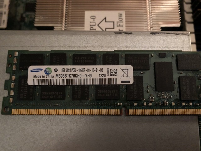

I’m using Samsung memory, tested with Memtest86. The sticks are good, if I shuffle them into working banks, they are seen without errors.
Samsung 8GB 2Rx4 PC3L 10600R 09-10-E1-D2 M393B1K70CH0-YH9

@Mirfster and others, what version of BIOS you have with all memory banks functional, is it 1.66 S99Q3B10? What dual processors you have installed with all banks populated?

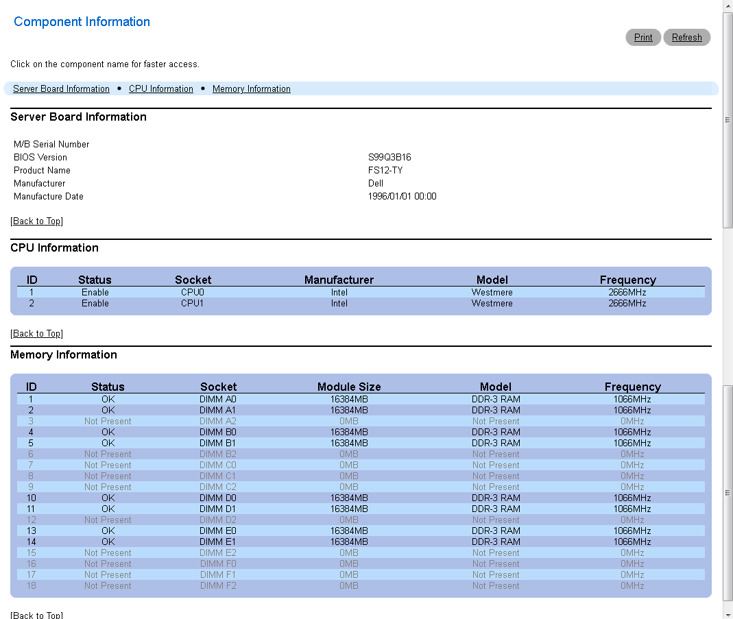

Here is one that is running 128 GB of RAM:
Mirfster
Oct 2, 2015
3,214
@TECK BTW, that is a super old version of BIOS you are running. I can't even find it listed here: http://downloads.dell.com/published/pages/poweredge-c2100.html. May also want to ensure BMC is updated (certain BIOS requires that the BMC is updated first), but it looks like you already have BMC 1.66.
For the record, I usually do 1.6 (ex. 1.66.65092 or 1.61.2527) and only up to BIOS version 16 (ex. C99Q3B16 or S99Q3B16).
I did briefly test the 3B25 version IIRC and while it ran fine I reverted, but don't actually recall why. /meh...

I updated to C99Q3B25 and the memory is still not visible. If I move the working memory into the middle banks, it gives memtest errors. Obviously the memory is good.

Are you setting it in pairs? Like A0, A1, B0, B1 then D0, D1, E0, E1. You can reference the image I showed earlier which indicates which memory slots I used.

Yes @Mirfster, I actually tried one sick first, A0, B0, C0, D0, E0, F0 (blue slots). B0 and E0 are disabled with memory errors. Yet, if I switch the B0 memory stick into A0 slot, it works. I'm losing my mind. :)

So what about in pairs like I mentioned?
For 4 sticks = A0, A1, D0, D1
For 8 sticks = A0, A1, B0, B1, D0, D1, E0, E1
