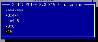

Actually playing with my X10SDV build at the moment :)
Super impressed with the bifurcation options on SLOT7
