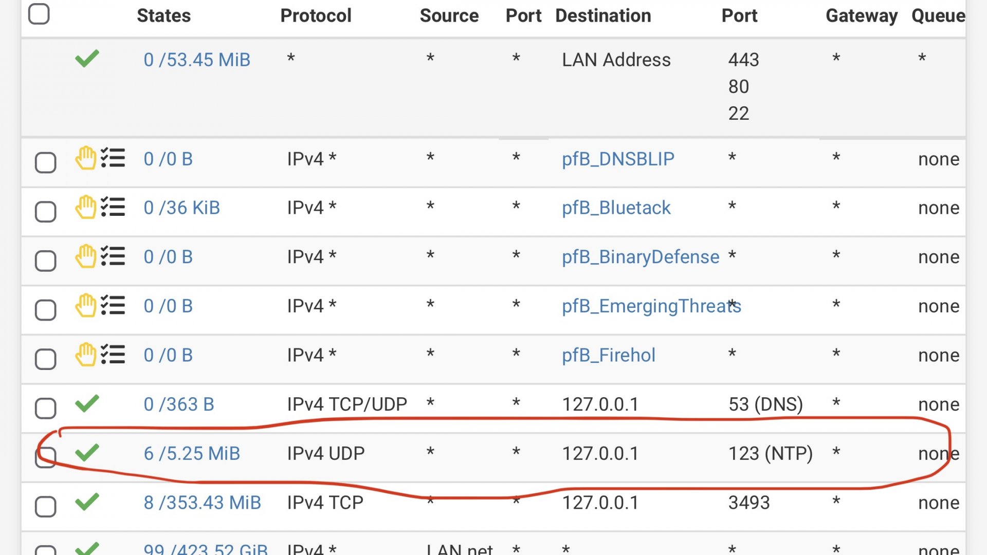

I run my own NTP server on my pfsense firewall and add a firewall rule to route outgoing NTP port 123 traffic to the localhost IP of my firewall.
NTP traffic is not encrypted, thus malicious actors can finger print what type of kit you have behind your firewall based on the NTP servers it reaches out to. By routing all NTP traffic to your own NTP server, the only kit that reaches out is your firewall. Also keeps all your kit in sync within a few microseconds.

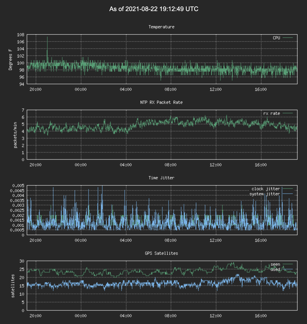

If you have access to a space under a roof, I'd consider installing your own NTP servers. I have one from centerclick, the other is running on a RPi
The NTP200 and NTP250 (POE powered) are set and forget, very simple appliances that simply get the job done. The RPI + Uputronics hat were a lot more challenging to set up but may offer more constellations and a better crystal. I got one of each since that gives some redundancy. The internet is the backup to both. I used Amazon metallized bubble-wrap bags as a ground plane below the puck antenna.
Neither antenna is installed outdoors and both receive 20+ satellite signals. Here is a NTP200 status graph as of this afternoon despite heavy cloud cover associated with hurricane Henri and all that.

My firewall is a NTP client using a pool of WAN facing NTP servers, each instance uses a random source port, thus not blocked by my ISP. Firewall then runs as a NTP server using its own acquired NTP time. All clients point to my firewall for NTP. The firewall rule forces all destination port 123 NTP requests to my localhost firewall NTP server. This prevents any clients from trying to access a WAN NTP server, even using a hard coded IP address. Doesn’t require any new hardware. Just enable NTP server in your firewall. Any decent router should allow you to run a NTP server. If the OEM firmware doesn’t, there are plenty of open source router firmware that you can flash over the OEM firmware. Example OpenWrt. I personally stepped up my game 7+ years ago when I switched to open source enterprise class firewall software http://pfsense.org
