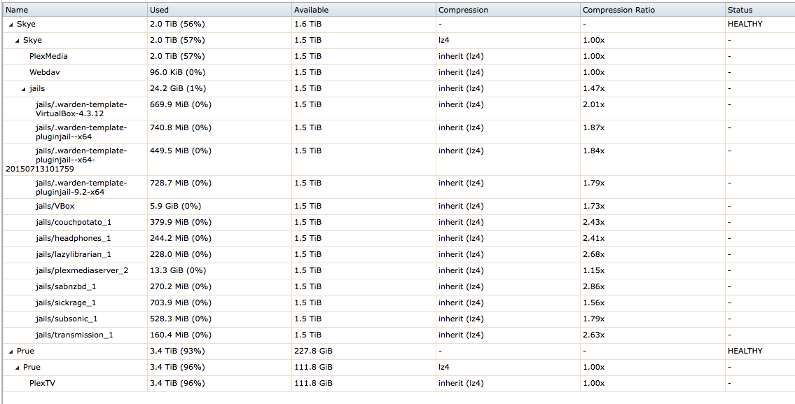

Now I have been running for quite some time with no issues whats so ever. Today I turned my server off to remove some redundant HDDs, these only stored pictures, nothing else no jails or plugins were installed on them drives.

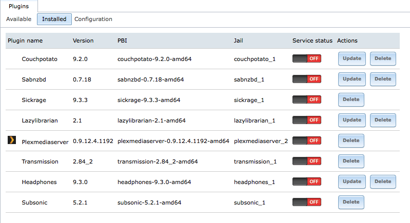

When I come to power the server on all my plugins won't start, they're not red and the jails are started and running, if I click the toggle switch nothing happens

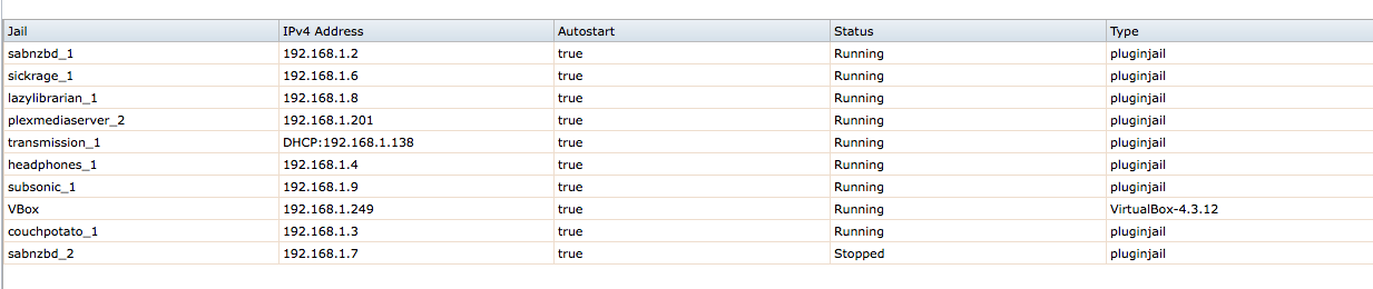

- The jails are running
- The storage is mounted and can be accessed, i.e. I can see the shares on my PC.
- The plugins aren't red
Running - FreeNAS-9.3-STABLE-201506292130
Platform - Intel(R) Celeron(R) CPU G1610T @ 2.30GHz
Memory - 10179MB
I'm not sure what information to upload, so let me know what you need and how to get it and I will post it.
I have played around with a couple network settings, but still doesn't start.

can you try running the below in the plex jail and post the output
service plexmediaserver onestart
