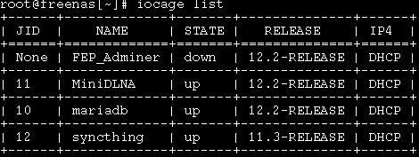

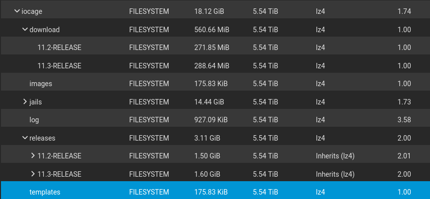

Running TrueNAS Core12.0-U1.1, I upgraded three of my jails to 12.2-RELEASE. No problems with upgrading, only one thing: there is neither an iocage/releases/12.2-RELEASE nor an iocage/download/12.2-RELEASE dataset, only the old 11.2-RELEASE and 11.3-RELEASE datasets.
Are those datasets only created by installing/upgrading plugins? The three jails I am referring to were manually created.

If you created your jails as clone jails (the default), they are still clones of the 11.x releases and iocage upgraded them in place. To provision new clone jails with 12.2-RELEASE, you would need to do an iocage fetch first. That would create the datasets you are missing.
Upgrading clone jails across multiple major versions accumulates a bit of cruft and somewhat thwarts the purpose of clone jails. I prefer base jails for that reason.
