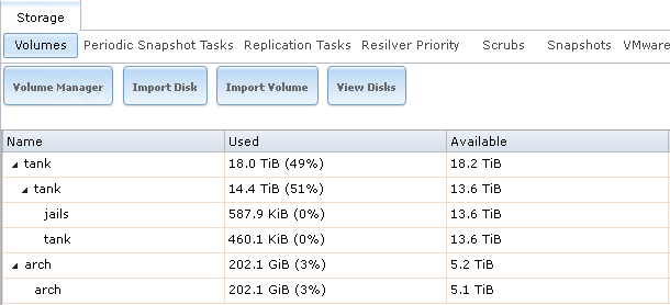

Hi! I'm having some troubles since yesterday because i had issues with AD connect, so i decided to roll back from 11.1 to 9.3. Sadly it seems that the wizard from 9.3 destroyed my dataset. Not that it's gone, but it is simply empty. The odd thing about this is, that even though my dataset /mnt/tank/tank is empty, the dataset before that (/mnt/tank) claims that it has 14.4 TiB used.
So that is:
Volumes: tank 18Tib Used, 18.2 TiB available
Dataset /mnt/tank 14.4 TiB Used, 13.6 TiB available
Dataset /mnt/tank/tank 357.9 KiB used, 13.6 TiB available
I went back to 11.1 and i'm having the same issues (had dual usb boot, so the problem shouldn't be in the config, as the volumes were fine before)
Is there a way to get to the 14.4 TiB - the data is displayed as used, so i guess there should be some way to access it..
I have no idea where and why the 14.4 TiB are gone and I was wondering if anyone else has had this issue before and if anyone could send me some help. Would be much appreciated!
Greetings from Austria!

You need to look at the snapshots and possibly roll back to the previous snapshot. You should not have an empty storage volume. You may have done this the wrong way.

Thank you for your answer Chris!
I have a Snapshot, it even refers to about 14 TiBs, but when i roll back to it, /mnt/tank/tank is still empty and /mnt/tank is not.
I assume the metadata for /mnt/tank/tank was somehow overwritten, if that makes sense. is there any way to get to some of the data located in /mnt/tank?
By now i know that i did something wrong. I just want to know if there is a posibility to get to my data..

15,504
Ah, indeed--it wasn't there when I first looked at it. I think you have one too many tanks. What happens if you do zfs unmount tank/tank?
Edit: I suspect that, under 11.1, /mnt/tank/tank/ wasn't a dataset, but simply a subdirectory of /mnt/tank/. When you created a tank/tank dataset, it hid the contents of /mnt/tank/tank/. If my suspicion is right, unmounting that dataset should let you see the contents of the directory.

Holy. You sir are a freaking genius. I'm able to see my files now - but only in ssh as of now. Under Volumes /mnt/tank/tank is still only a few bytes and zfs list looks the same. Is that because of the dataset? Is it save to delete the dataset?
15,504
Yep.
There's nothing in there, so sure. You might want to wait until you have a share set up and are sure you can access your files over the network as desired though.
