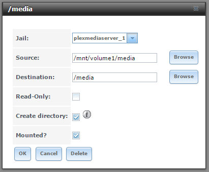

I installed PLEX plugin on freenas 9.10. Installation worked fine. It set up a Jail automatically. I added storage to the Jail. PLEX Server is working, but it has no access to media. The storage added to the Jail doesn't appear there. I hope, you understand what I mean...

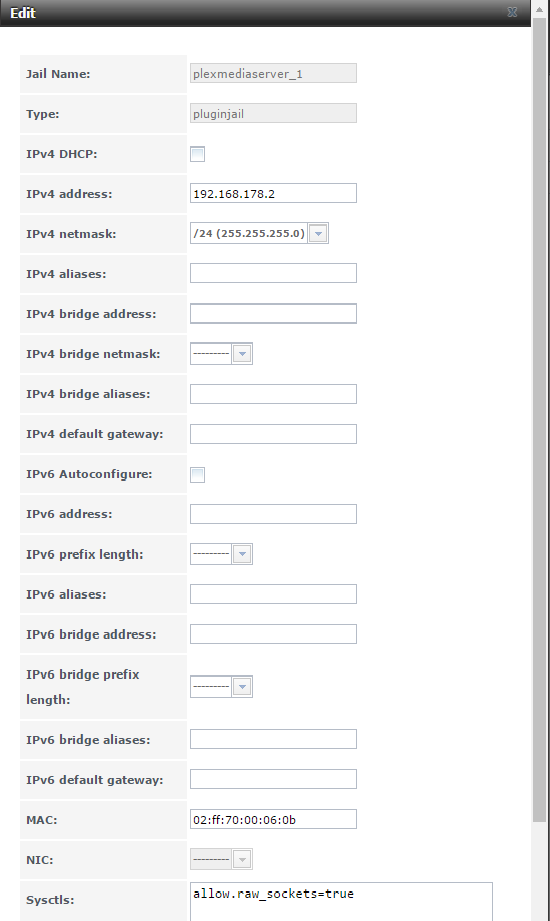

Can you post a screen shot of your storage configuration for this jail?

Not on the picture:
- autostart: YES
- VIMAGE: YES
- NAT: NO

And you don't want your jails to have access to internet either apparently? You have no gateway configured.
But.
What @danb35 was asking is that you provide a screenshot of your storage you added to the jail...

what happens when you go into your freenas webgui and you go to:
Jails -> View Jails -> Storage (Tab) -> Add Storage (Button)
And set your video/picture/music storage folder as a mnt point in your plexmediaserver jail? (Lets call it /media), Do you get an error at the top of your screen? Or does it say successfully added?
This works fine. No error. It does not say anything, but there is a new row, with columns "Jails: plexmediaserver_1, Source: /mnt/volume1/media, Destination: /media, Mounted? true, Read-Only: false"

Now inside the Plex jail, what happens when you 'ls /media'?
Does it show your media?
Yes, it does!
Does /mnt/volume1/media contain other datasets? If you have datasets under the media dataset, you will have to share each one separately.
I think, that's the point! I added parent directories. Adding a subdirectory with media seems to work!

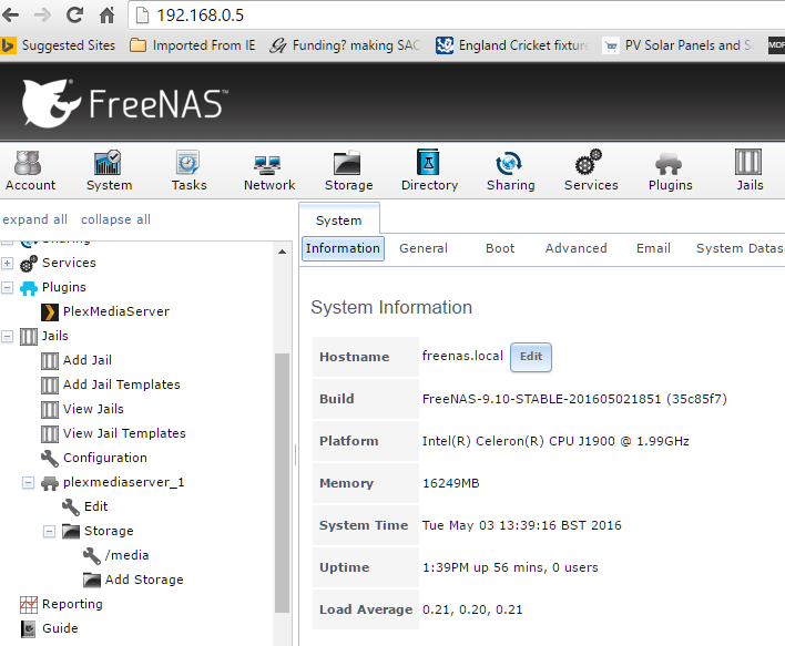

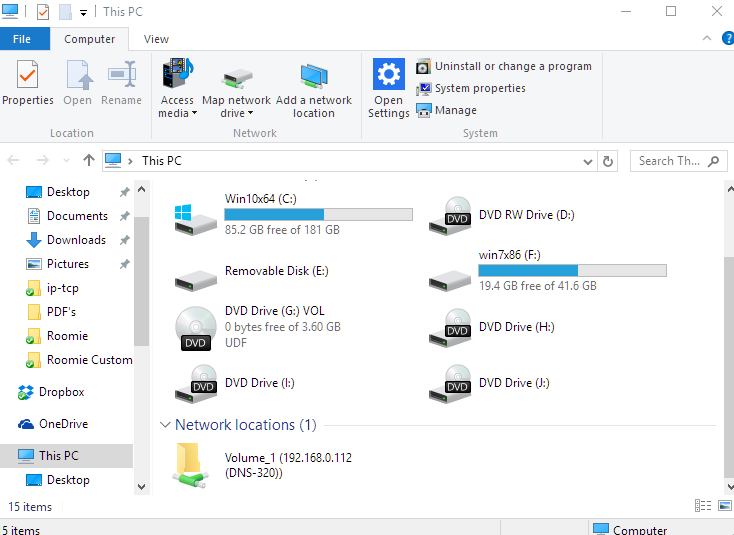

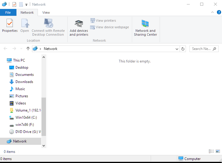

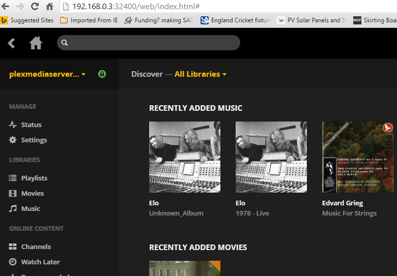

Hello,
Having upgraded to 9.10, I can access the freenas web gui and the web gui of the plex plugin media on my pc. But, cannot access the media via the pc. Not showing in network or 'this pc'.
jeff hughes
Dec 5, 2014
5
Do these files help?
Before upgrading to 9.10, I was able to access the plex media folders on the pc, and map them.

Your media should not be IN Plex. It should be in datasets on your pool.
I have no idea what you're referring to with these images. NetBIOS discovery is perpetually broken in Windows....
