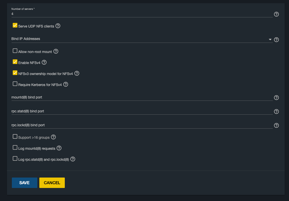

I am attaching my NFS settings page. Also please note that I've checked "Serve UDP NFS clients", but the output of rpcinfo -p does not show any UDP ports.
Any thoughts as to what may be wrong?
Thanks!

The rpcinfo has mislead you, this is mine:
[chris@freenasB ~]$ rpcinfo -s
   program version(s) netid(s)                         service     owner
    100000  2,3,4     local,udp6,tcp6,udp,tcp          rpcbind     superuser
    100005  3,1       tcp,udp,tcp6,udp6                mountd      superuser
    100003  3,2       tcp                              nfs         superuser
    100024  1         tcp,udp,tcp6,udp6                status      superuser
    100021  4,3,1,0   tcp,udp,tcp6,udp6                nlockmgr    superuser
[chris@freenasB ~]

You don't need to select "serve UDP clients".
Not necessarily related but I did report a bug in FN11.2 relating to NFSv4/3 selections not resetting correctly : https://redmine.ixsystems.com/issues/66961 this ended up being merged to https://redmine.ixsystems.com/issues/68815 and I cant be sure it was ever resolved in FN11.2-U2.
P.S. If you look at the file /etc/rc.d/nfsd you will see the tunable "vfs.nfsd.server_max_nfsvers" should be set to 4.
