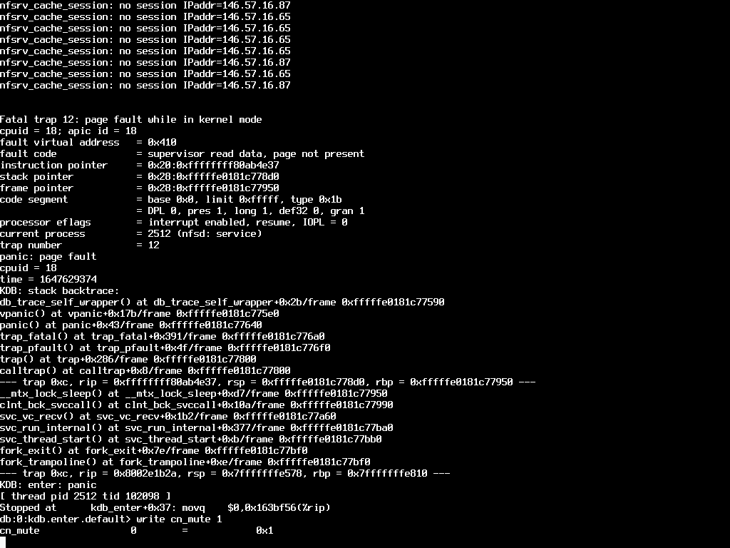

Hi all,
I have an NFSv4 share that is causing my system to crash. I am not sure nfsrv cache session is. Has anyone seen this before? Any suggested resolutions?

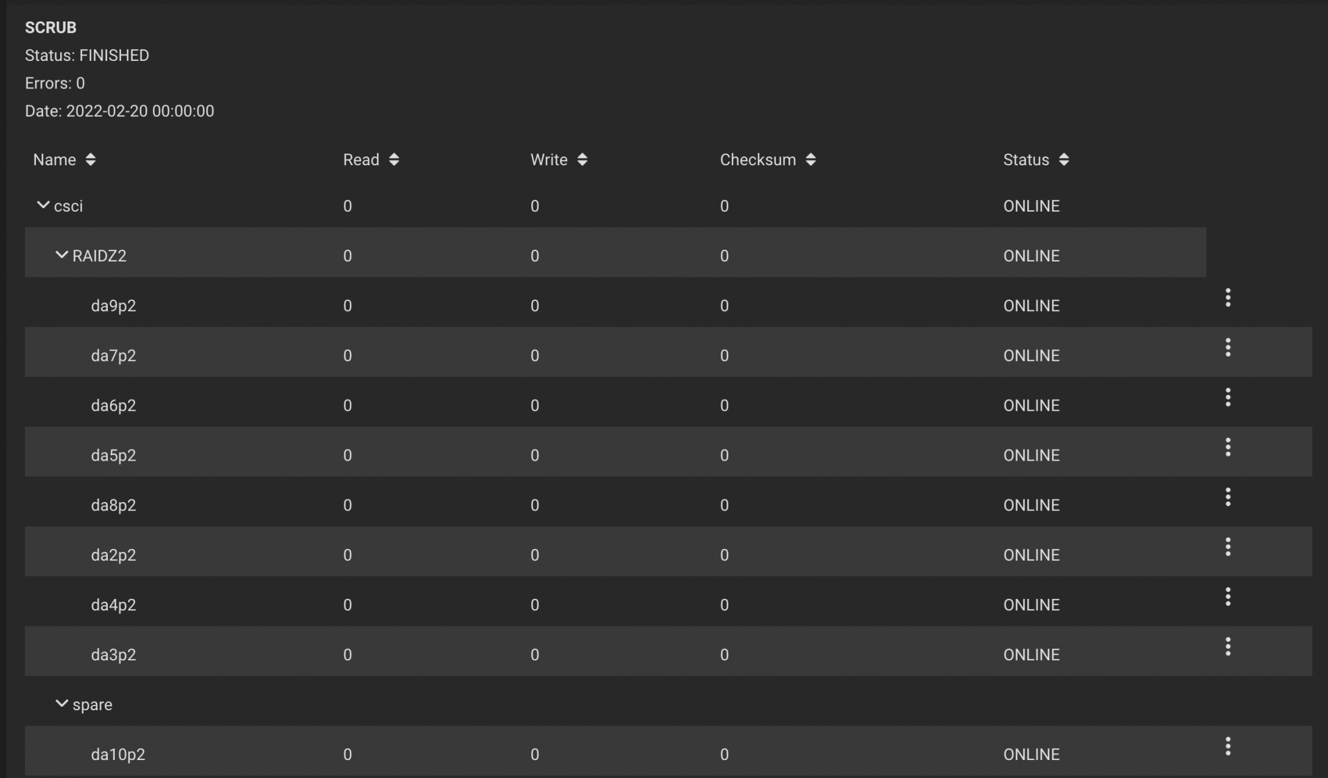

  • Full scrub on your pool(s) to make sure that data is good.

Hi Nick,
Thanks for the suggestions! I did your recommended steps and unfortunately, it did not turn up any issues. My apologies for not looking at the forum rules closely enough. Hopefully I can correct that mistake here.

I tested the memory through the BIOS. I have not been able to reliably reproduce this issue since doing a cold boot of the server/sled setup. I took a look through the crash log after the suggestion to attach them and I noticed that the Dump header is from device: /dev/da10p1. I believe that this is from a hot spare drive that I recently added to the system. In the past, I have noticed issues with the compute node and dive sled connection if the system does not do a cold boot. I had not done a proper cold boot since installing that drive, so my best guess is that rebooting with cold boot fixed the issue. Here is the log I am referencing:
