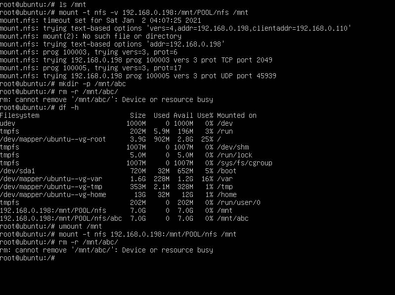

I mounted scale's nfs on another machine of ubuntu, then I created a subdirectory abc in /mnt ,but i can't delete it,device busy?
because the subdirectory abc has been mounted to /mnt/abc automatically,but it's good in truenas core.

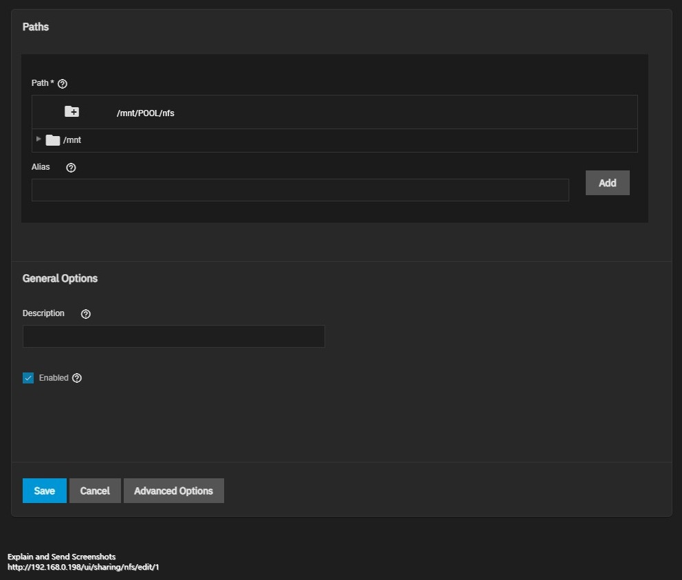

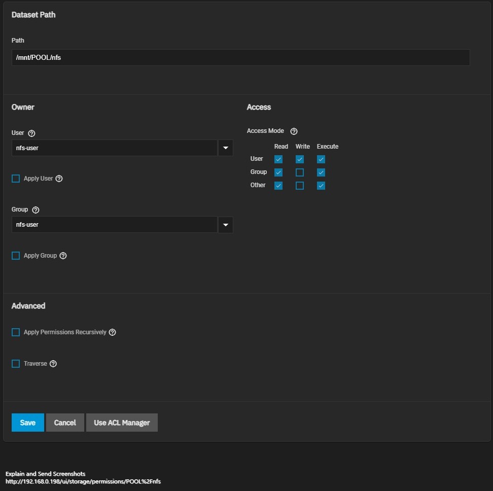

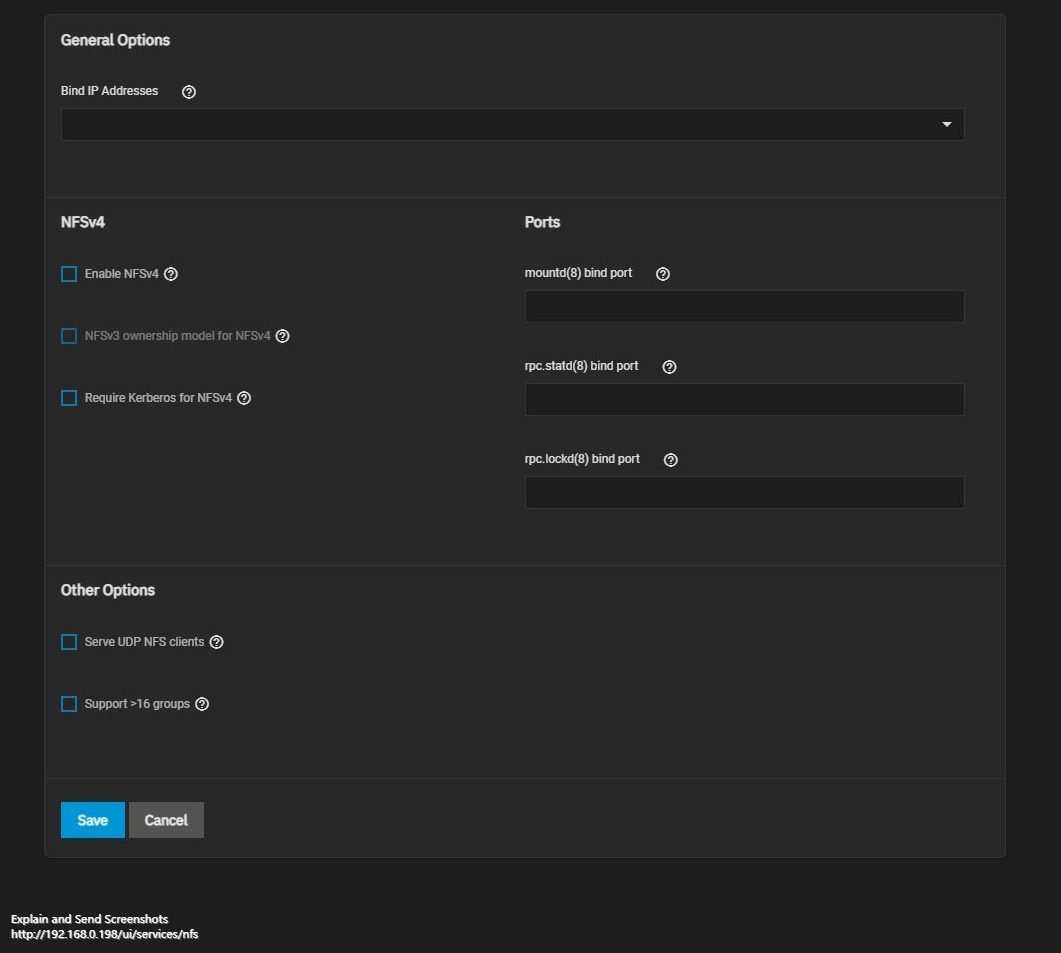

Here are my steps:
1.---create a dataset named nfs in scale,and set the permission.
2---config nfs sharing
3---config nfs service
4---On another machine,i mount the nfs to /mnt,and i create a subdirectory abc,at this time,i can't delete it!
