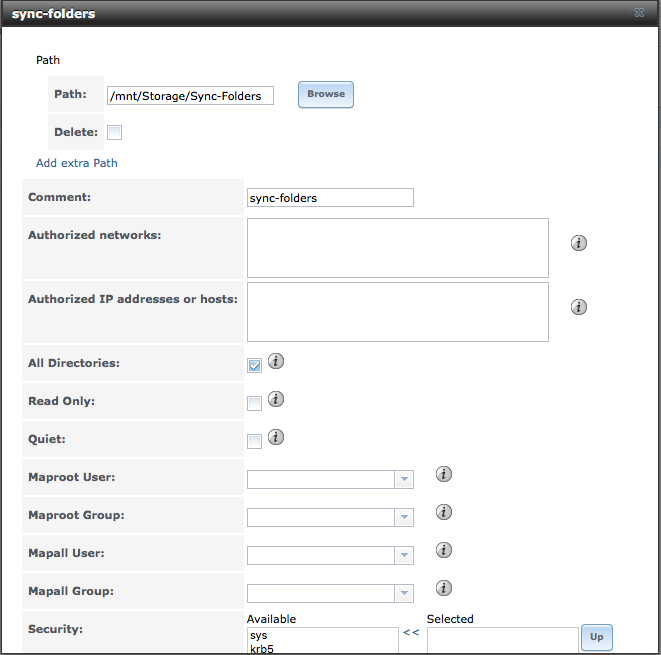

Can you share a screenshot of your NFS settings on FreeNAS?
The first thing that jumps out to me is possible permission issues, but I hate starting with that one, because I find that it's very difficult to troubleshoot remotely.

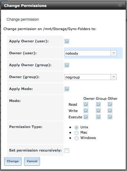

Thanks for the offer for help. I've attached both my NFS share screenshot as well as the data set settings.

Everything looks right. I would recommend adding specific authorized hosts, but that shouldn't be your problem since you can connect to the shares. Can you check the permissions on the mounts from both the OSX and Ubuntu boxes? ls -la I'm wondering if OSX is doing something slightly different than Ubuntu, and I wonder if that has anything to do with OSX's BSD origins vs Linux.

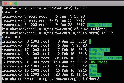

Screenshot from Ubuntu

Permission look ok. If you do a touch /mnt/nfs/sync-folders/test.file, what happens?

Okay... I think I fixed it. Here's what I did. These files are files that I have sync'd across multiple macs and my FreeNAS. I went into the permissions and I re-set them recursively. Interestingly enough, ubuntu still shows them as owned by Root, but after doing that, I can now write files directly to the share in Ubuntu. So it was definitely a permissions issue...
