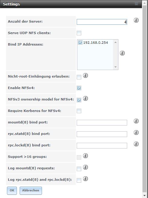

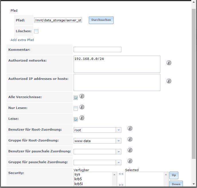

1 NFS ( Share on /mnt/data_storage/server_storage )

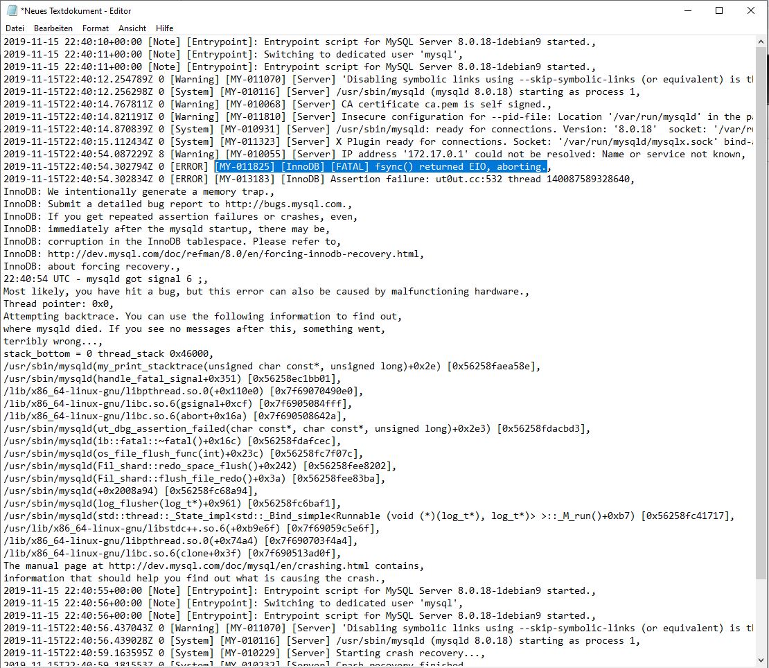

On the First docker have a Mysql and Nextcloud the Second have nothing. (Clear install)
When i use the frist one solo all works rigth. Wenn i start the second the mysql crashed every time. (jpg Crash).

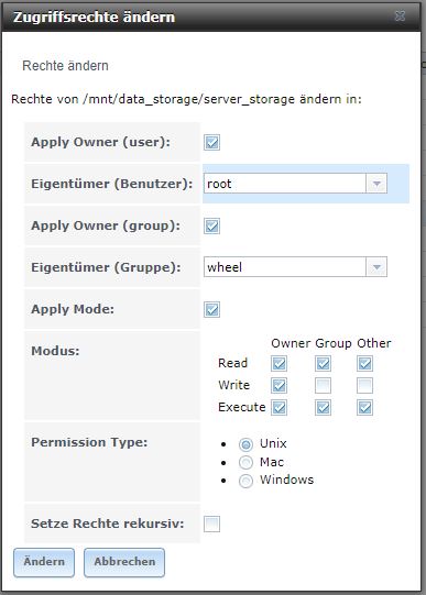

server_storage is the dataset and vm01 only a normal dir createt over shell. (root:wheel)
I dont understand why they crash with "[FATAL] fsync() returned EIO, aborting."
This are 2 different dirs and there no data that the both write in the same time.
I Make 2 tests:
Put a second mount in the first Docker works. Start second Docker same Problem.
make a second ZFS and put the new dataset on the second Docker same Problem.
Whats i WRONG?
