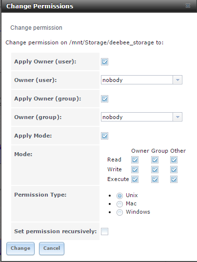

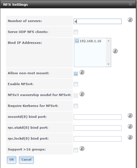

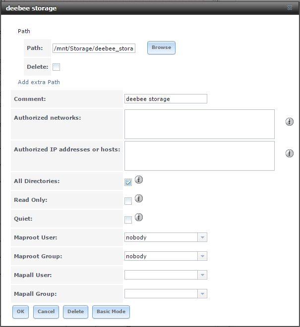

So my setup is as follows:
And here's what the share looks like on the vm side.
And then in the respective .conf files for each program I have the datadir set as those. Each server is running as its normal user (mongo/mysql)

So, is it a permissions problem with the share.... a problem with MySQL.... I'm pretty stuck at this point :/
