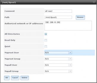

FreeNAS NFS share configuration attached: Screenshot-02032012-08:16:30.jpg

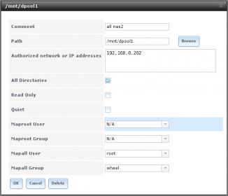

I changed my settings for: 'Authorized network or IP addresses' from 192.168.0.0 (attempt to reference the subnet) to 192.168.0.202 (actual address of my workstation) and that seems to have gotten rid of the: 'mount request denied from 192.168.0.202' at the freenas server but .... still I have the RPC issue and no mounting at the workstation. I also changed the mapalluser to Root and mapallgroup to wheel. see second attachment: Screenshot - 02032012 - 08:31:47.jpg
Partial SOLU: to the 'Authorized network or IP addresses':
Apparently in FreeNAS v8.0.3 (WebGUI) you can only enter EITHER
* Single network entry [ xx.xx.xx.xx/xx ]
* Single OR multiple IP address entries [ xx.xx.xx.xx xx.xx.xx.xx xx.xx.xx.xx ]
. . . . . . . . . . . #(space delimited)
See: [ _http://support.freenas.org/ticket/1076 ]
