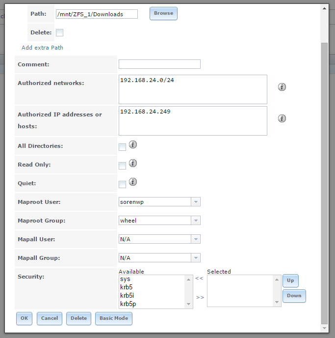

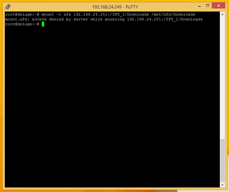

I have make a NFS Share, but when i try to mount it, i get this error ""access denied by server while mounting"
- is it totally wrong as I have done it?
oh yeah i have taken some pictures :)

Nothing glaring in the config. Anything in /var/log/messages on the FreeNAS side? What's the operating system you are trying to mount from?

mount from debian 7.7 :P
- but my windows and VMware can't too
log:
Jan 14 15:24:41 freenas mountd[27319]: mount request from 192.168.24.249 for non existent path /ZFS_1
Jan 14 15:24:41 freenas mountd[27319]: mount request denied from 192.168.24.249 for /ZFS_1

The non existent path is the issue, not sure why you're getting it though as underscores are supported by NFS.

But if you look at my pic, the path is /mnt/ZFS_1/Downloads, i use the "browse" so can't understand why ?
maybe a bug?

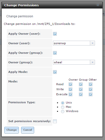

Try one more thing.. Change the ownership of the dataset to the user instead of root.

same problem, i have tryed all :P

The other problem I have quite often with nfs is that nfs uses the UID number rather than the name
On your client #id and map the UID to sorenwp on the freenas
