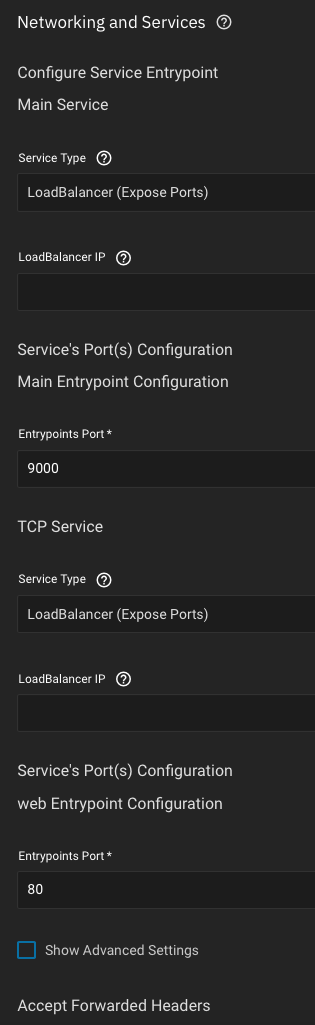

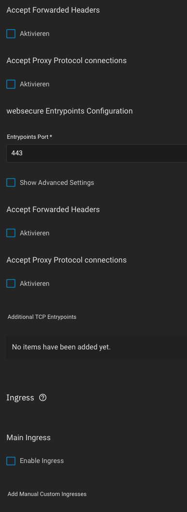

here my configurations

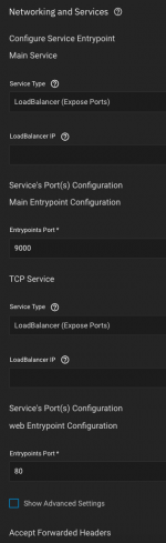

Traefik:
all other points are not changed.

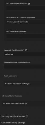

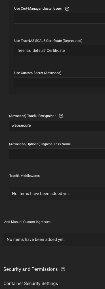

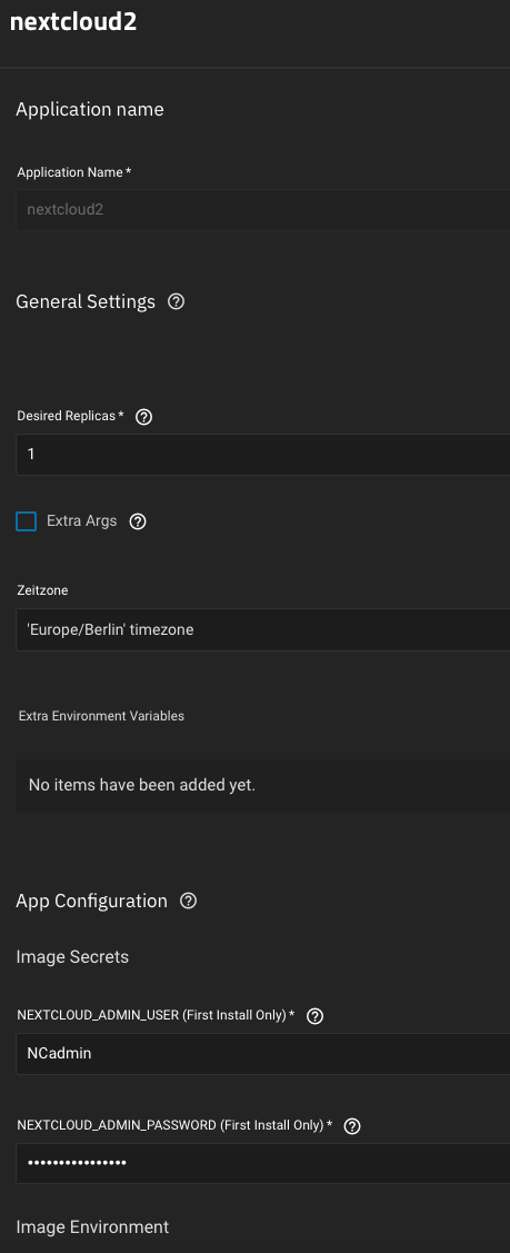

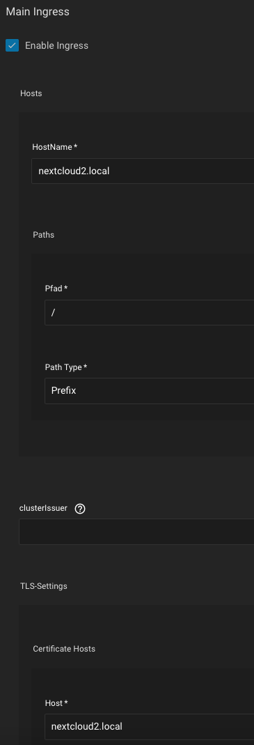

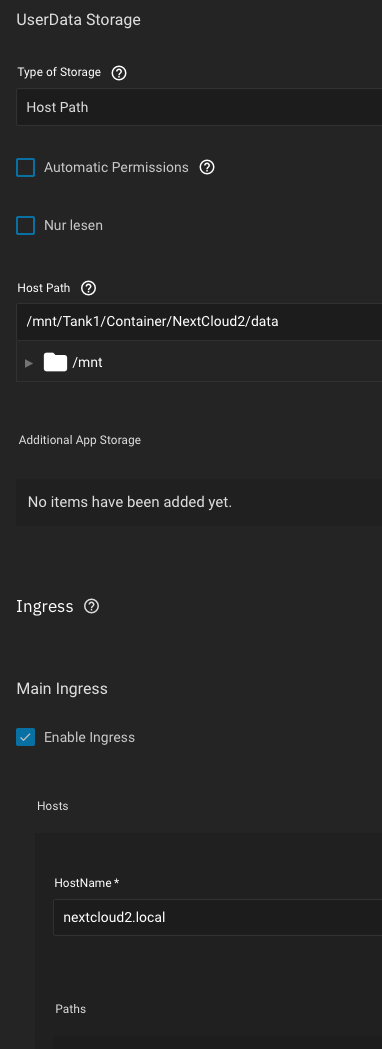

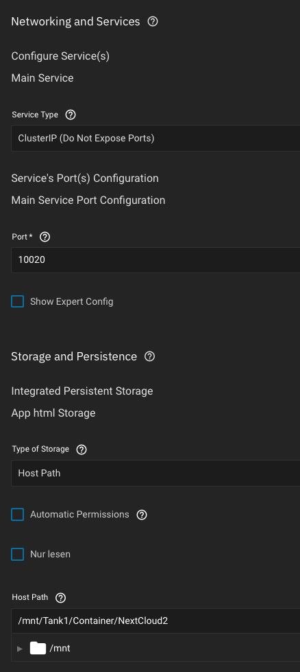

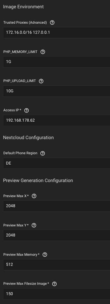

Nextcloud is configured as followed:
following points unchecked.

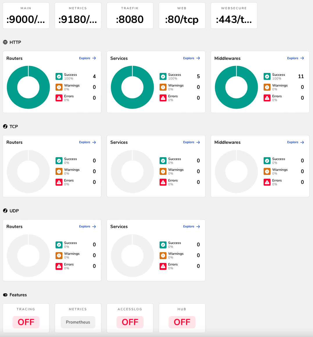

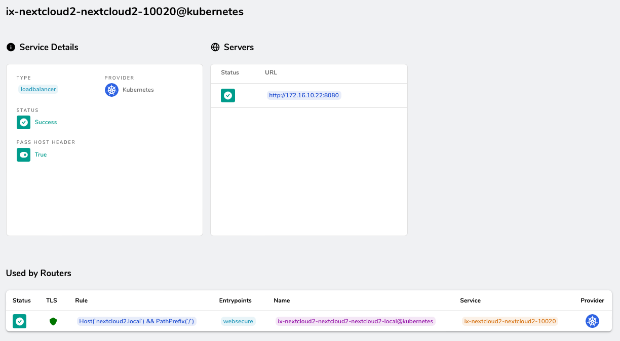

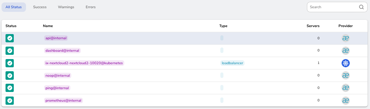

Now I see in Traefik the following screen:
i think this looks not bad. If I try to reach my nextcloud from the app-menu from truenas it tries to reach https://nextcloud2.local, but after 1 second the address switches to https://truenas.local:444/ui/apps. 172.16.10.22 seems to be the cluster-ip of cubernets as I understand.
I can access this nextcloud-instance with http://192.168.178.62:10020. But this does not work with https. Logged in to nextcloud it indicates that https is not configured.
