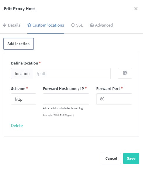

I tried to enter the same but in the custom location tab, thus I don't think I'm doing it properly as it ends up with Nextcloud being completely unreachable, when I remove it's working again in WebUI but still all other errors.
