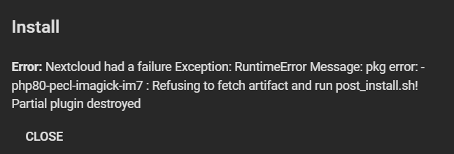

Everytime I try to install the Nextcloud plugin I get this error message:

Ok so I am also trying to install nextcloud on TrueNas core 13.0 U1.1 from the official plugin and getting error:
Error: nextcloud had a failure Exception: RuntimeError Message: pkg error: - php80-pecl-imagick-im7 : Refusing to fetch artifact and run post_install.sh! Partial plugin destroyed
Preinstalled the whole TrueNas OS and I get the same error.

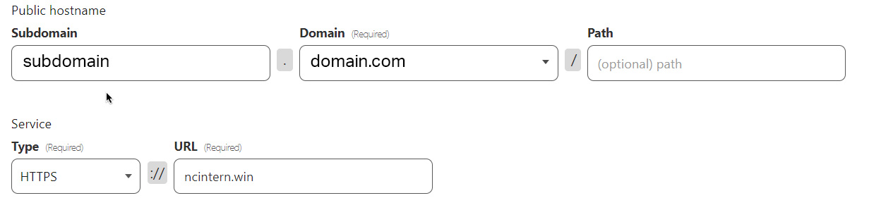

I have now attempted to bring nextcloud online following this guide and I'm running into a 502 Bad Gateway error.
These are my tunnel settings:

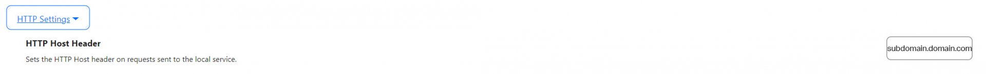

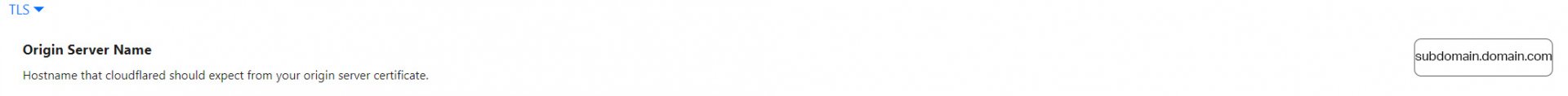

The URL part can be your jail IP. If using HTTPS you will need to “Disable TLS Verify” but if you have a valid cert you can leave this setting.
Fill in your domain name under “Origin Server Name” and “HTTP Host Header”
Did all that and I'm still running into the same error. Another thing I noticed is that if I try to access nextcloud through the jail IP I get an SSL protocol error. Accessing it through the assigned domain works fine tho
