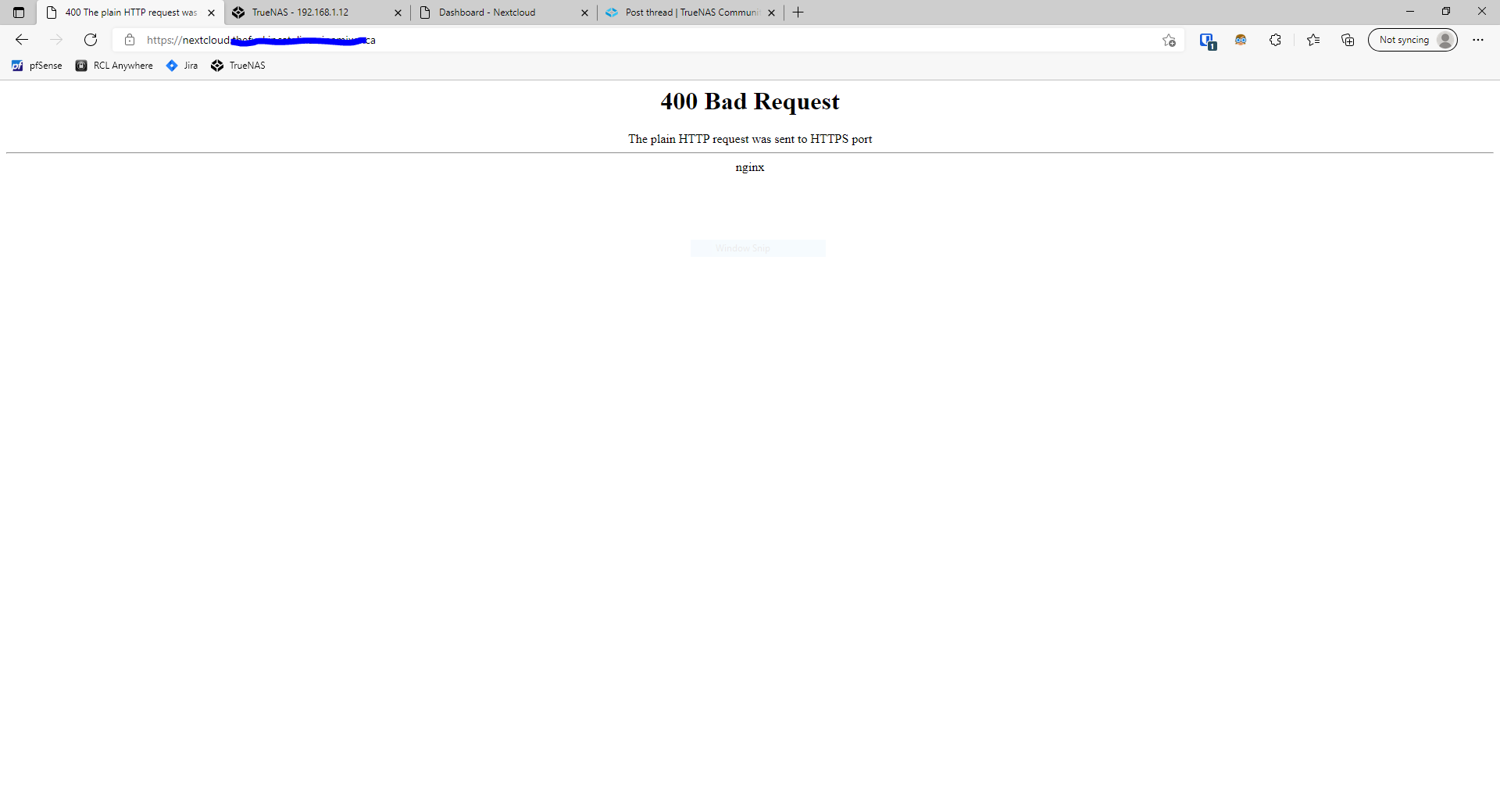

Anyways, every time I try to access my Nextcloud server now (after changing HAProxy to redirect to port 8283 instead of 8282), I get a screen saying:
"400 Bad Request. The plain HTTP request was sent to HTTPS port".
Now I can only access Nextcloud through the "Manage" button on the plugin page.
