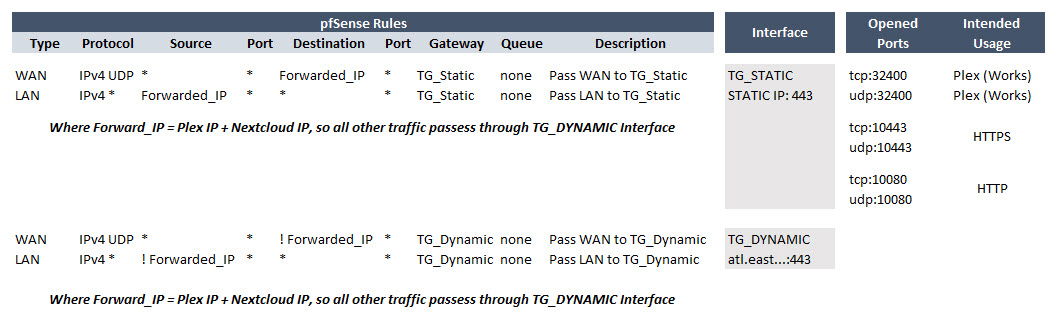

  • While I don't care much about Plex being externally accessible, I used that as a "test case" to defeat the fact that I'm being double NATed and don't have a static IP.
  • I did so with the following configuration in pfSense: (a) Configured OpenVPN Clients [1], (b) Created appropriate Firewall Rules [2], (c) and Added a Port Forward [3].
  • Plex is externally accessible. Shamefully I should admit this took me quite some time to figure out.

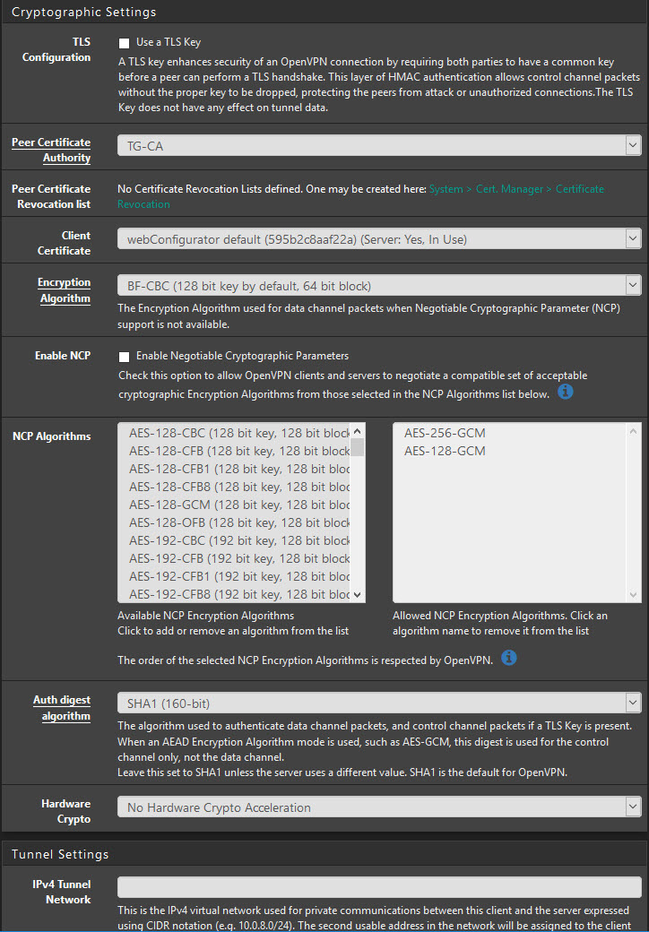

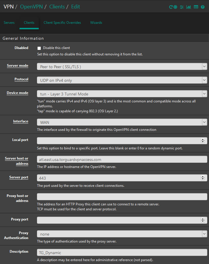

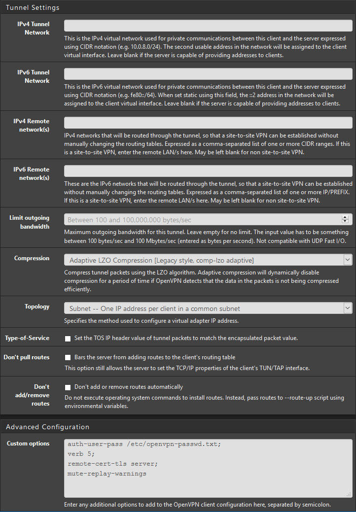

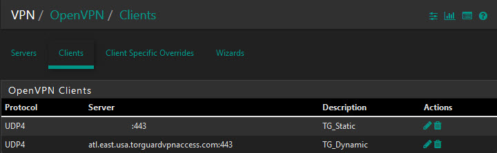

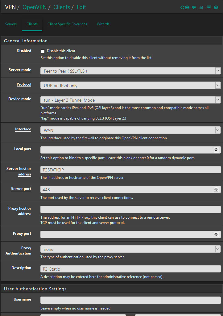

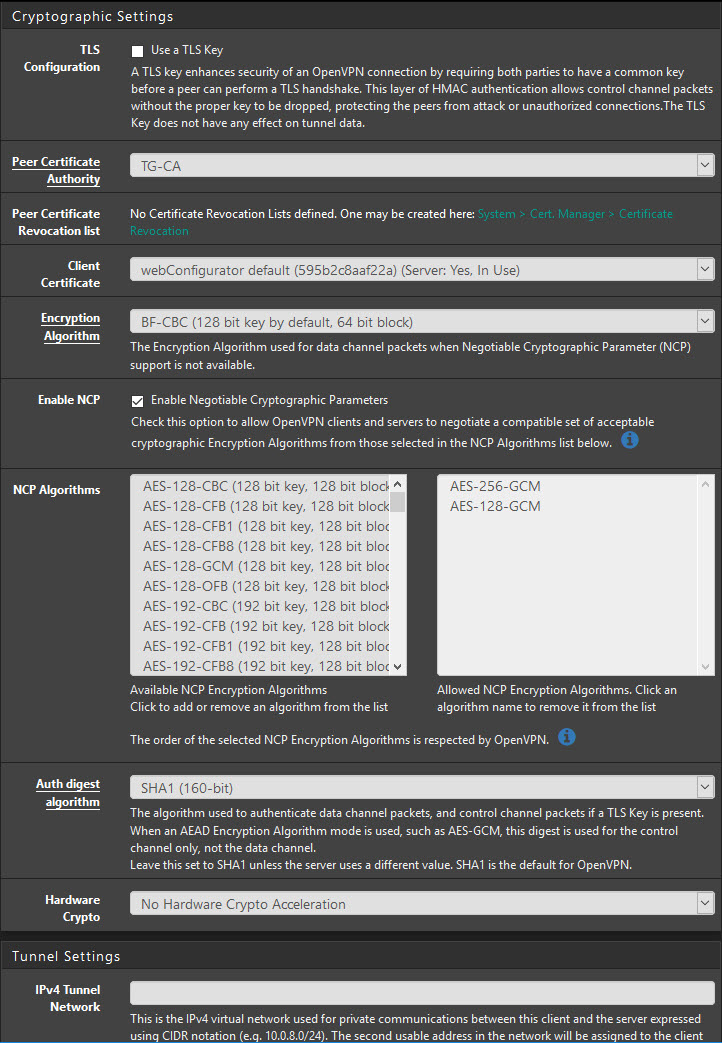

[1] pfSense: VPN / OpenVPN / Clients
Summary:
TG_DYNAMIC Config:
TG_STATIC Config:

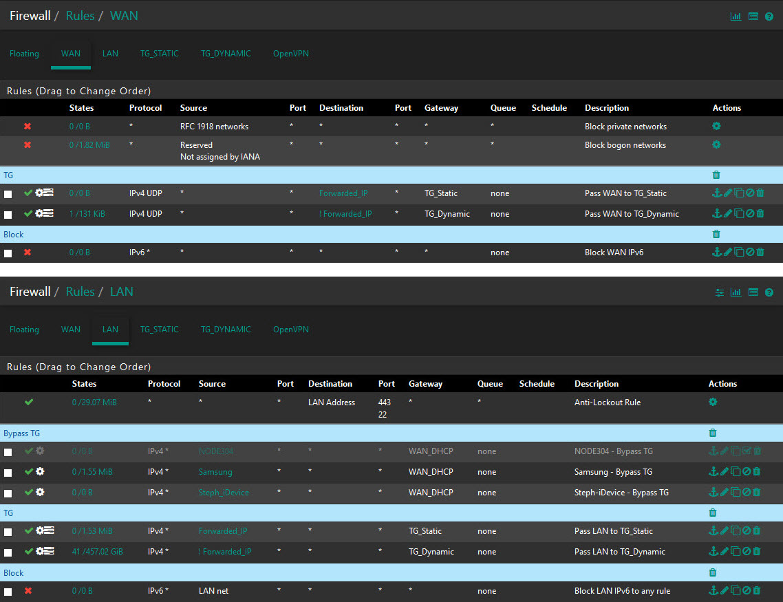

[2] pfSense: Firewall / Rules / WAN & LAN

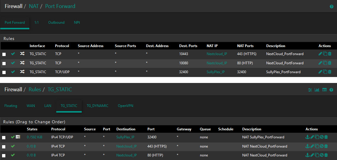

[3] pfSense: Firewall / NAT / Port Forward

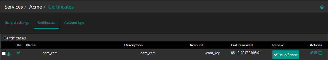

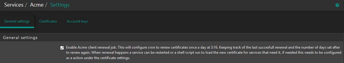

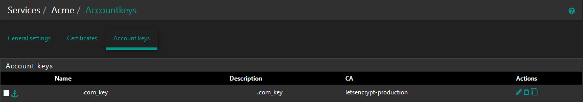

A. ACME package in pf, I have successfully edited DNS text record to achieve validation.
Able to obtain / renew the cert using the "ACME Certificates" package in pfsense.
domain.com_cert
Renewing certificateaccount: domain.com_key
server: letsencrypt-production
/usr/local/pkg/acme/acme.sh --issue -d 'domain.com' --home '/tmp/acme/domain.com_cert/' --accountconf '/tmp/acme/domain.com_cert/accountconf.conf' --force --reloadCmd '/tmp/acme/domain.com_cert/reloadcmd.sh' --dns 'dns_nsupdate' --log-level 3 --log '/tmp/acme/domain.com_cert/acme_issuecert.log'
Array
[path] => /etc:/bin:/sbin:/usr/bin:/usr/sbin:/usr/local/bin/
[PATH] => /etc:/bin:/sbin:/usr/bin:/usr/sbin:/usr/local/bin/
[NSUPDATE_SERVER] => /tmp/acme/domain.com_cert/domain.com/nsupdate
[NSUPDATE_KEYTYPE] => host
[NSUPDATE_KEYALGO] => 157
[NSUPDATE_KEY] => /tmp/acme/domain.com_cert/domain.com/nsupdate
[Wed Dec 13 21:52:52 EST 2017] Registering account
[Wed Dec 13 21:52:53 EST 2017] Already registered
[Wed Dec 13 21:52:54 EST 2017] Update account tos info success.
[Wed Dec 13 21:52:54 EST 2017] ACCOUNT_THUMBPRINT='blah blah'
[Wed Dec 13 21:52:54 EST 2017] Single domain='domain.com'
[Wed Dec 13 21:52:54 EST 2017] Getting domain auth token for each domain
[Wed Dec 13 21:52:54 EST 2017] Getting webroot for domain='domain.com'
[Wed Dec 13 21:52:54 EST 2017] Getting new-authz for domain='domain.com'
[Wed Dec 13 21:52:54 EST 2017] The new-authz request is ok.
[Wed Dec 13 21:52:54 EST 2017] domain.com is already verified, skip dns-01.
[Wed Dec 13 21:52:54 EST 2017] Verify finished, start to sign.
[Wed Dec 13 21:52:55 EST 2017] Cert success.
