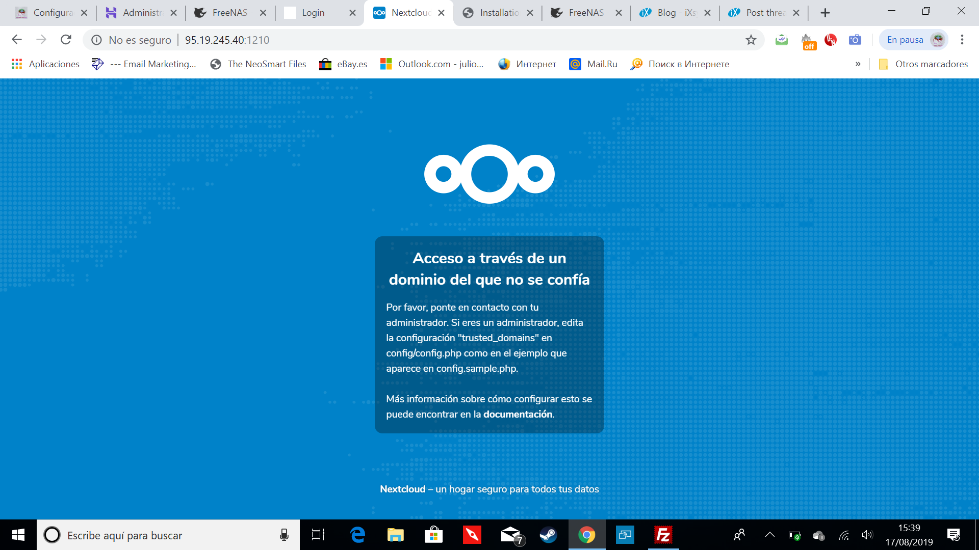

hi. i need some help because i want to use my nextcloud server with my public Ip but i need to add it to my "config.php" file but i don't know where i can find it.
so please help me....
15,504
i want to use my nextcloud server with my public IP

You could add the IP address as a trusted domain in the config.php file (you'll need to manually edit that, not through the Web UI) but it's really not recommended and would be incredibly insecure!

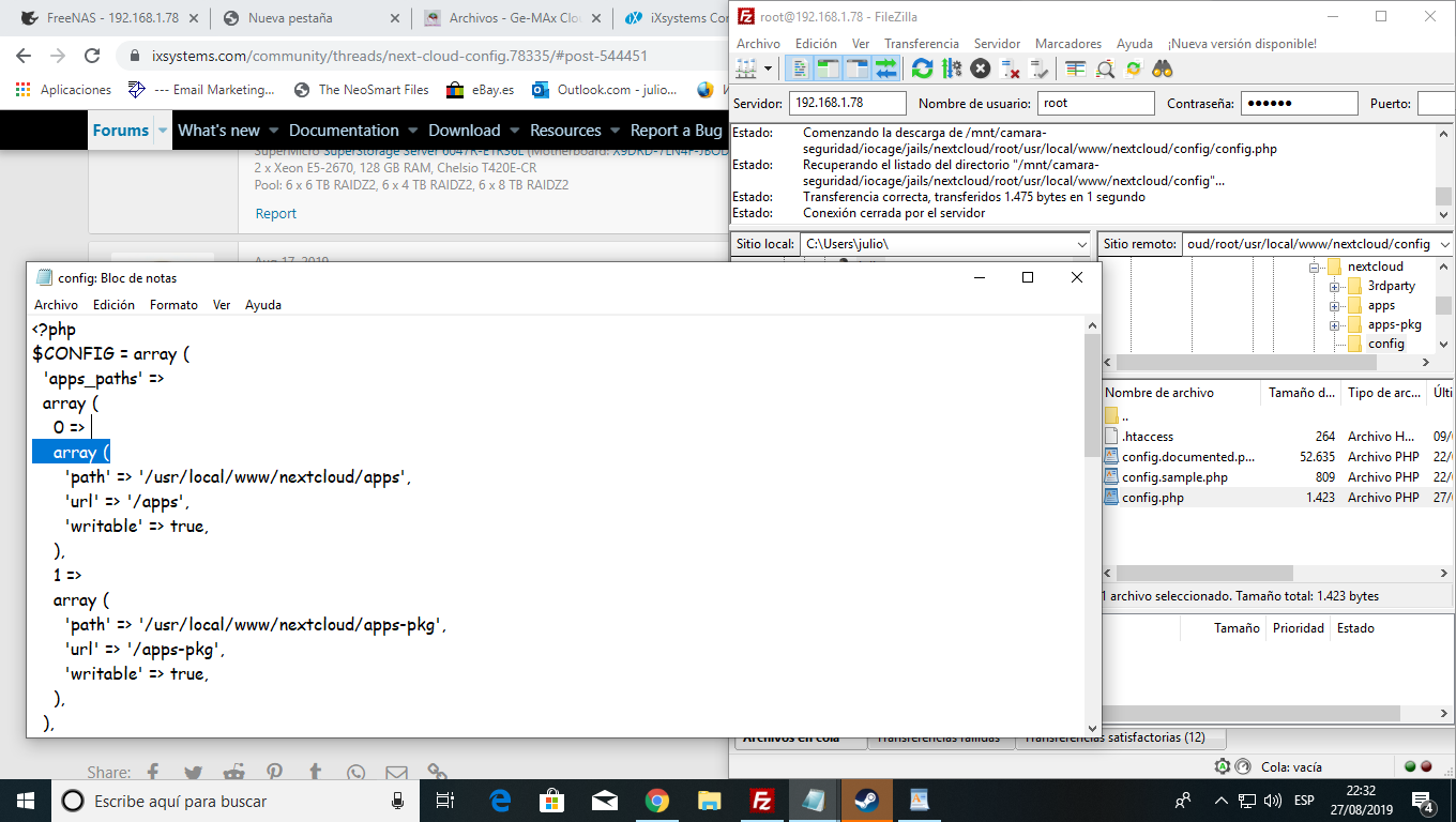

so i find my own solution to find the config file. that's the direction
/mnt/camara-seguridad/iocage/jails/nextcloud/root/usr/local/www/nextcloud
(you have to change it to your pool in my case is "camara-seguridad")
and if you have a problem when you "upgrade" a plugin when it start to "developer mode" here you can change it
('maintenance' => false), change it to True
