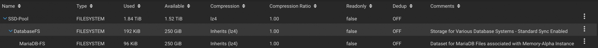

I have a Dataset structure like this on my SSD pool (the description indicates that sync writes are enabled so I can do some A/B performance testing with sync/async modes later--I'm sure I'll end up leaving sync off, but I'm curious to see the difference in actual use).

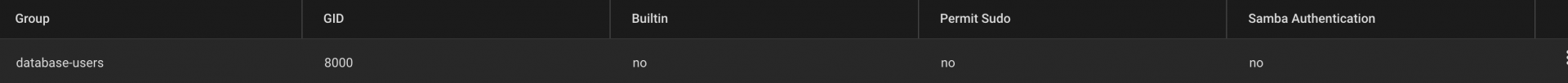

I've set up a group for database users.
