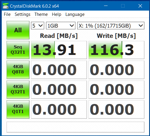

So, I built a TrueNAS box for the first time, and here's what I'm getting over SMB. This lines up with the general file transfer status I'm seeing in Windows. I'm trying to figure out what I've misconfigured or something
Hardware:
CPU: AMD 2400ge
MOBO: ASRock B450M Pro4 R2.0
RAM: 16GB Unbufferred 2400mhz ECC DDR4
HBA: LSI 9207-8 in it mode
NIC: Mellanox X3
HDDS: 6x 4TB WD Red Pro in Z1, lz4 compression
generic 120GB SSD boot drive,
16GB Intel M10 NVME as cache
TrueNAS version: 13.0-Release
Drive is connected with a 2m copper DAC to an Aruba S2500. Both TrueNAS and the switch are reporting 10gbe.
I've tested with and without the cache drive and it doesn't make a difference in any way. I only included it because I had one lying around, and I realize it's probably not doing what I had initially assumed it would do as the RAM is the actual ZFS cache.
While I have a 10gbe NIC in the box, the Windows computer I'm testing with is just using a standard 1gbe. I haven't thrown the X540 in yet, but I do have it. Obviously won't matter right now with the read speeds like that.

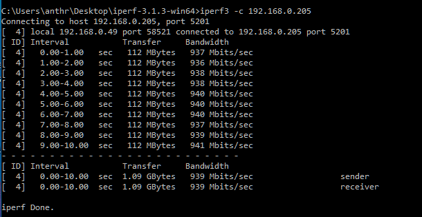

My next thought was network speed, and again, with 1gbe on the other end:

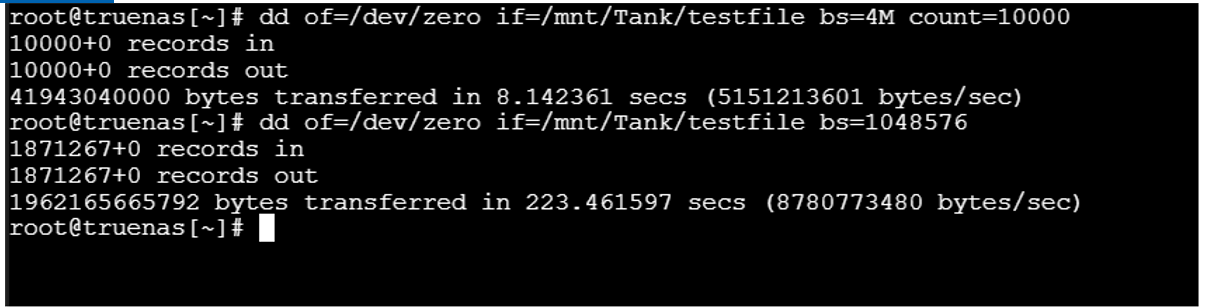

I did a quick read test across the array (I didn't turn compression off, but more looking to see if there was something obvious I was missing):

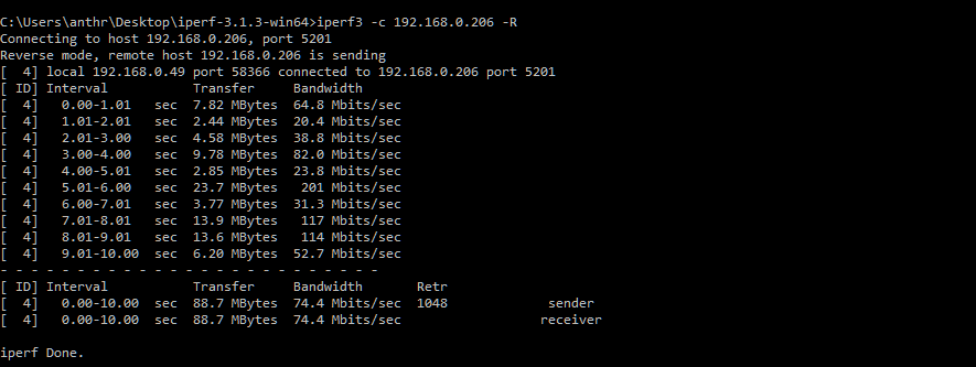

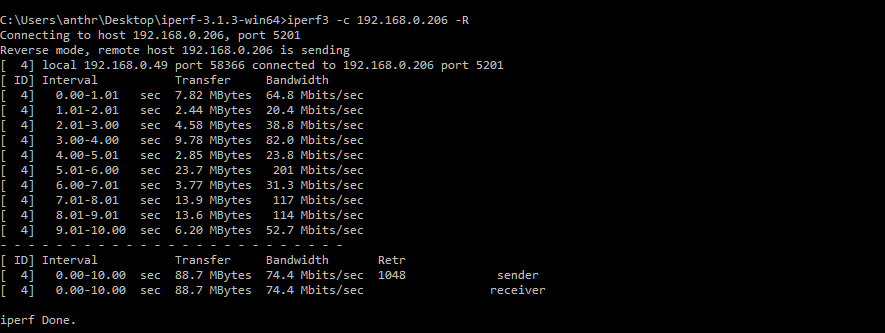

have you done an iperf3 with -R to test the other direction? could try iSCSI as a quick sanity check too, if iperf3 looks ok. have you checked to make sure MTUs are matching and there's no fragmentation going on?

Ok, so checking MTU's
Router: 1500
Switch: 1514
Nas: 1500
That has everything working great except the NAS. I bypassed the 10gbe card and just used the 1gbe RJ45 on the motherboard and got exactly the same results - lots of retransmitted packets, terrible read speed, write to the NAS is unaffected.
Checking for fragmentation, I need to lower the MTU from my windows 10 PC to ~1475 to get fragmentation to stop (using this methodology: https://kb.netgear.com/19863/Ping-Test-to-determine-Optimal-MTU-Size-on-Router) but the lowest value I can use in truenas is 1492 - which didn't affect anything.
Is there anything else network wise that I'm missing?
