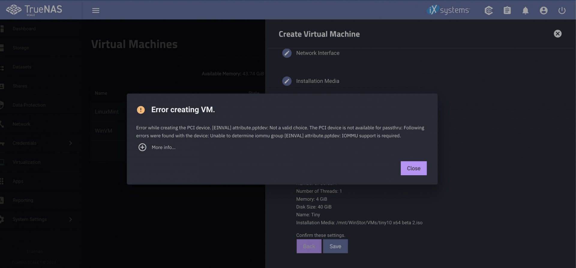

Thanks everyone...I did buy a cheap Quadro P1000 to help with some plex transcoding but i dont believe that does audio and anyways when i try to pass it through to a VM it gives me a IOMMU error even when im using intel and have all the virtualization options enabled in the bios

This is what i get when i try to pass through the P1000.....Im running a 13th Gen Intel
