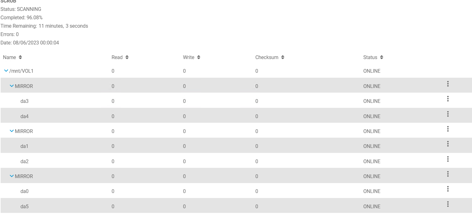

I provided my conceptual config for a new array, since in my mind running raid 0, then mirrored I didn't think about how ZFS looks at it.
This is my current setup for the array.
What I'm trying to do is improve performance by running 12GB SAS SSD's. Because some scenarios I have been reading about 4kn drives I wanted to avoid any pitfalls, as well as make sure running that my new concept would be optimal.
