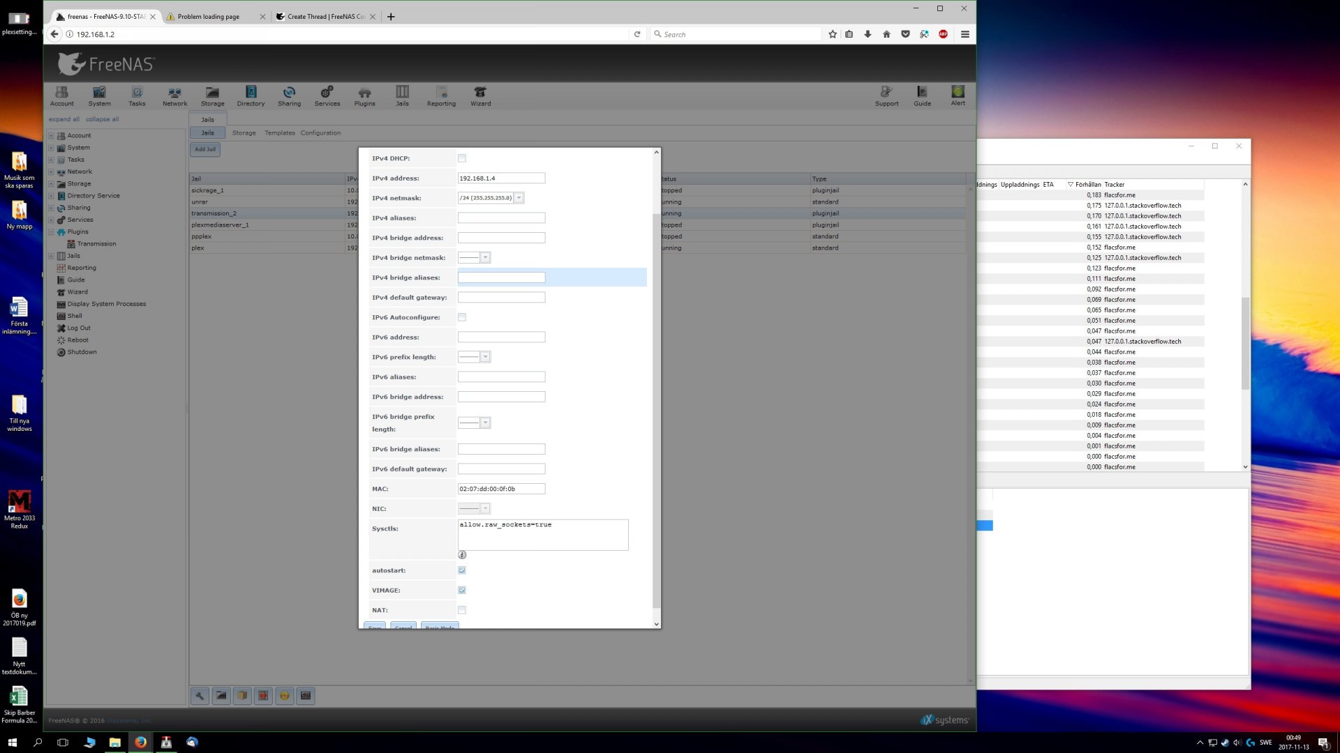

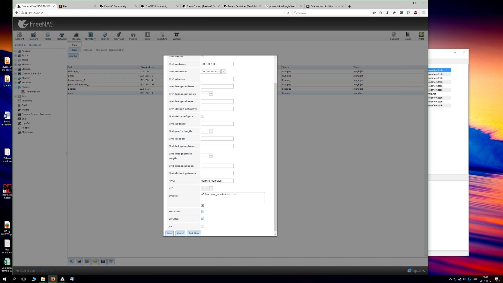

The Plex server is running and is (kind of) functioning. I can access it from my iPhone and playing it on my TV via chromecast works perfect. But... when I want to access the server gui I fail. I enter 192.168.1.x:32400 in firefox which loads plex but it can't find my server, it says "looking for server". See uploaded picture.
I'm a total "noob" but in my eyes this is a bit strange, I would have guessed that it either should work or not, not something in between. It's clear that the jail is up and running but still I can't truly access it.
